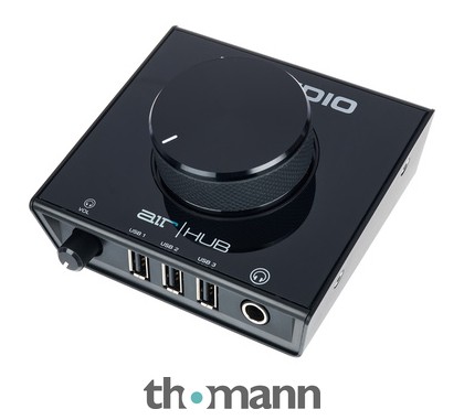

Oh didn't know they eliminate the unbalanced input. Maybe something like this? Can drive headphones as well.
Or just the Air Hub if all you need is playback.
