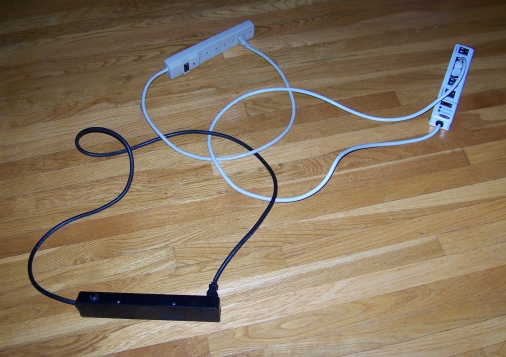

That's ridiculous. A surge protector can't provide power to itself.
You need at least two. Plug #2 into #1 so the second gets power from the first. Then plug the first into the second so the first gets power from the second. THAT'S how you get your infinite power.
You need three
one needs to be black, you know, to ground it.

You need three
I knew I shoulda paid more attention to my E-M courses while I was in college. :(
Thanks for correcting my misinformation! You probably saved some lives here. :thumbsup:
