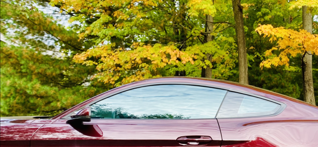

Well I dropped my car off today for tint on the front windows and a ceramic coating.
It takes over 8 hours for everything so I'll be picking it up tomorrow at around 5pm.
I'll post some pics afterwards. I didn't take any before pics since it was dirty but I have some from the dealership and right when I got home so it will be somewhat of a comparison shot.

I am VERY happy with the results. I'd say the pics don't really do justice to just how everything looks in person with the shinyness/reflections. I wish I had gotten a rear shot from inside their shop with the perfect lighting.
