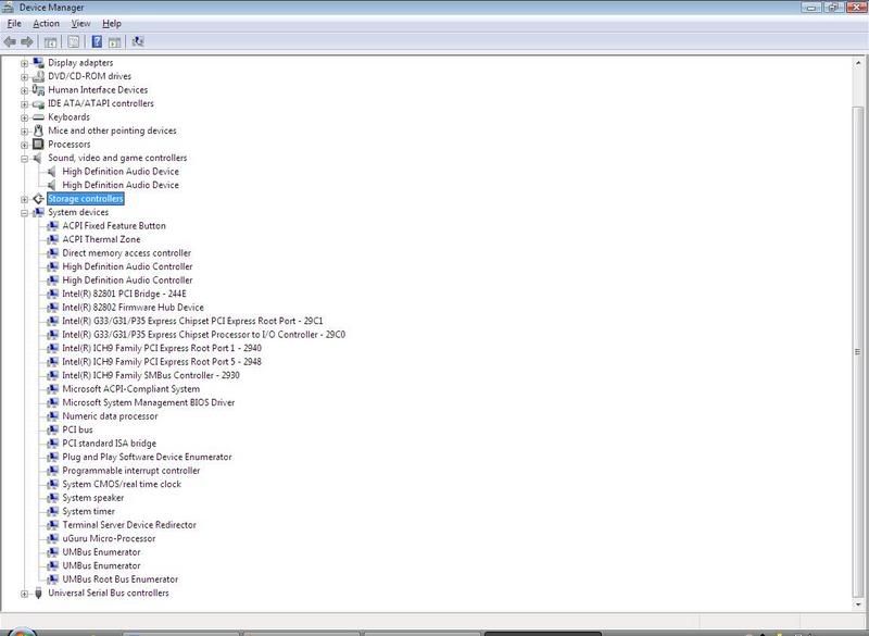

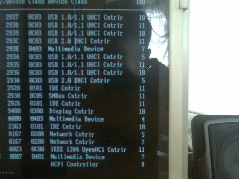

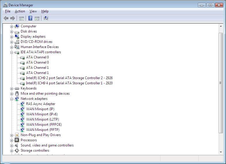

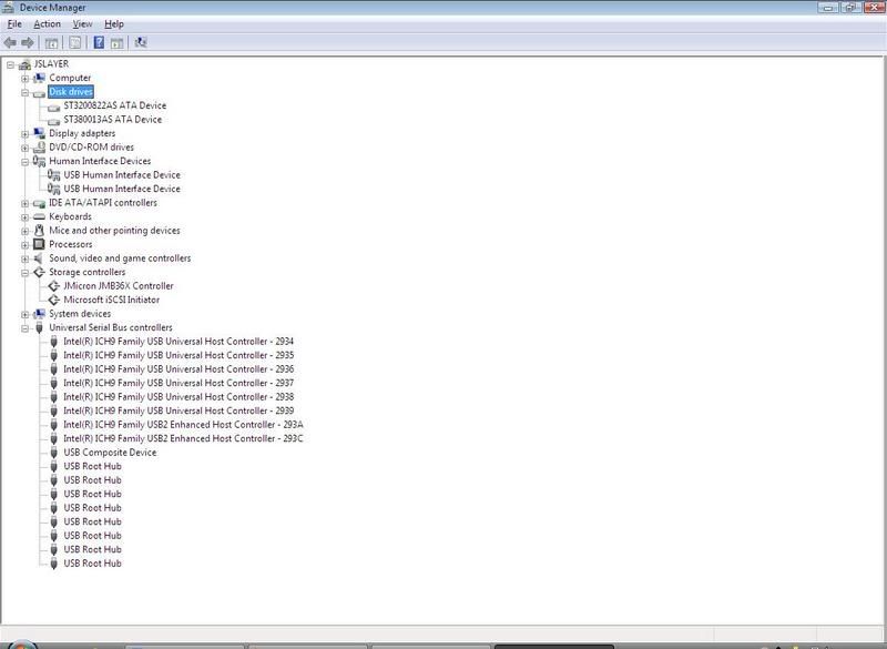

Hello,
I'm having problems with my mboard and I'm not sure if it's the cause of software or hardware faults.
Currently, all the PCI slots are failing and not detected at all, and the Realtek LAN isn't working either, although there is the yellow light when I plug a LAN wire into either of both.
Here are my specs:
Windows Vista 32-bit
Abit IP35 Pro
Intel Q6600 at Stock Speed
300GB Harddisk
4x 1GB Kingston HyperX CL4 Memory
2 IDE DVD drives
Ac-Bel 550W Power Supply
Hopefully, someone has a clue as to what's happening...
I've installed all the chipset drivers and tried flashing the mboard bios as well to no avail.
Thanks!

It really does seem like it's completely a software problem... since it works when I did XP...
Only reason I want vista to work is DX10...

Just a long shot here, but have you tried installing the Realtek driver from the CD that came with the motherboard? I don't think Vista auto installed a driver for mine.
I ask because I'm not sure if Vista will show you hardware in the device manager that isn't installed correctly (like XP). It might, but I can't remember if it does or not.
