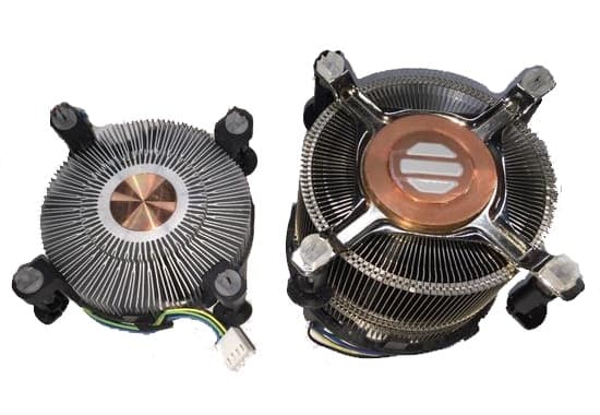

1. The Heat sink you listed is a alu fin with a copper core heat sink.
Its design was very common on LGA775 Quadcore cpu heat sink.
LGA775 Quadcore Heat sink:
TS15A Heat sink:
What is the difference?
From the looks of it the height of the copper core.
Also the density of the alu fins which is wraped around the alu core.
Now Copper is a better thermal conductor then alu.
This is physics, so its undisputable, however many vendors have marveled on the idea to hybrid the heat sink copper / alu for weight and cost reason.

The TS15A is about the biggest, heaviest cooler that Intel thinks can ship installed without damage. It also installs from above, with no need to access the back of the motherboard. It's a near certainty that the 212 Evo will cool better, but it is tall, heavy, should be removed for transport if it will not be in your care, and might require motherboard removal on cases without a windowed tray. For a new build, the last thing is not a real consideration, as long as one remembers to install the retention mechanism before installing the motherboard.

I read on a few pages that the fin design is actually different from the old models and indeed uses a heat pipe. I actually purchased this cooler for my new build and with no plan of overclocking, I expect this will be a great combination for my machine. I just like to get opinions and I do appreciate your input. Do you mean that Intel is purposefully selling crap because they are mad at us or something? According to this page, they are adopting what other coolers are doing. I also doubt that this will damage the chip due to the lack of a mounting plate.
"The thermal solution features a large copper base along with the company’s copper “heat-column” with a heat-pipe inside, which has been used by Intel for some time. For the first time, Intel uses assembled high-density fin design for the heatsink of its coolers to maximize heat dissipation area. Previously the company utilized solid-state heatsinks with curved and bifurcated fins, but it appears that it is now adopting the same construction as leading makers of thermal solutions."
http://www.kitguru.net/components/c...-cooler-to-date-ts15a-for-lga1151-processors/

This cooler will handle a stock 6700K with ease if you have sufficient airflow through your case. I would guess that it should be able to handle a mild overclock as well, should you decide to explore that feature.
The reason it's not going to get much respect here is that as a group, most of us who reply are enthusiasts who prefer higher performance solutions. The cooler you have chosen, while significantly better than the old copper cored Intel cooler, would likely not support a maximum effort overclock the way that other, much larger air coolers would. Since that doesn't matter to you, you are good to go.

https://www.anandtech.com/show/10500/stock-cooler-roundup-intel-amd-vs-evo-212/7
The TS15A is only a few degrees behind the 212 EVO even at 150W. 5db louder than the 212 EVO.
