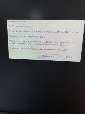

One more for entertainment value while we wait for more news
EDIT: Most of the posts trending on PCMR at the moment are all covering this. Have fun with the Streisand Effect you incompetents at Intel.
