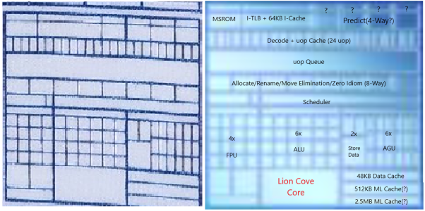

Sounds exciting, if true.
I wonder how these changes will affect the area, though. Doubling the ALU count and increasing decode width by 50% can't be cheap area-wise?
The official graphics of Lunar Lake (given they show the real scale) already show that 4 Skymont are definitely bigger than 1 Lion Cove, so the 1/4 the size of a P-Core definitely isn't true anymore.

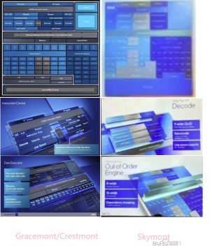

I don’t know what to make of this
Wow! This is exciting.
What I can make out:
-Flexible & Scalable: Shows Lunarlake and Arrowlake
-Increased IPC Gains: Left is likely Int and right is FP. FP gains are greater. Integer gains seem to be not 1.1n x but 1.2n x or 1.3n x.
-Two graphs of "something" Power and Performance compared to another core. Guessing one is for performance and other is for power(Arrowlake and Lunarlake). For the Performance graph it shows 2x performance with more power. At the same power it seems to be showing 1.5 or 1.7x. It also seems to say "1/3 power" at same performance. The low power graph shows massive gains(2.4x at the same power?), probably compared to Crestmont LP? Scales to 4x or 5x compared to Crestmont LP at higher power.
-Skymont uArch Goals
-"something" Decode: 9-wide(3x3), "Nanocache"?
-"something" Predict: 128 bytes, Faster
-"something" OoOE Engine: 8-wide and 16-wide, Dependency "streaming"?
-Deeper Queueing with More Resources
I said it before and I'm calling it now. 10% faster in Int and little bit behind FP compared to Golden Cove.
