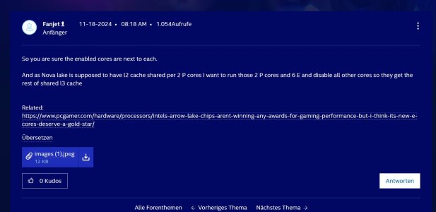

What do you think about this than it is a leak from Intel forums basically lowering the Ring stops for cores from 12 to 8. This will help with the L3 Ring latency as well and would dramatically improve the PPA for Core+L2?
I struggle to find a leak in what you posted. As far as the idea to share stops for P cores, it sounds like cutting your toes to perfectly fit the bed: the ring may be fine, but the suffering will move elsewhere.
I'm open to opinions on why a shared L2 could be worth exploring, but I fail to see how moving a bottleneck from the ring to core clusters would help performance in latency sensitive workloads. (games, we always mean games)
Something to consider is that the P cores have kind of been adding an additional level of cache internally lately, roughly a level "0" cache in addition to the L1. Assuming that they can keep L2 cache latency low, and bandwidth high for each core, as long as they aren't hitting the L2 more than 40-50% of the time per core attached to it, it shouldn't be too bad. There are a couple of people out there that have done some limited gaming runs on just the e-cores with a modest overclock and they haven't looked too bad, even if those clusters aren't optimized for that sort of activity.
Is that dude not just a random user? The rest of the thread seems to be Intel just saying we can't comment on future products.
I also don't think the leak specifies that it would lower the ring stops either, I think that's just speculation from the rumor.

Sharing cache between the Lion Cove cores could work if a single core isn't taking advantage of it much on its own. Maybe increase it to 4MB per two cores and it could potentially reduce ring traffic in multicore workloads that rely on a lot of cache hits.

Not to forget by sharing caches you cut the number of P cores on a Ring by half lol
