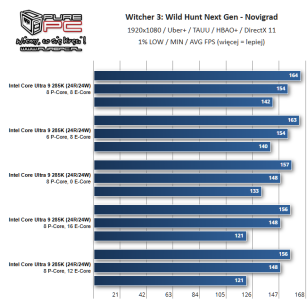

It seems that 8pcores, 8 e-cores is 5% faster then 8p/16e.
Guess 8p/8e works like 8p+ht... Great work intel
I wonder how those 8 e-cores are being distributed? Are they activating just two quad core clusters, or are they distributing them evenly across all 4 clusters? The unified L2 in the quad core E-cores clusters can result in cache/memory contention issues for the E-cores when they get heavily used. Limiting to one or two cores per cluster gives much more L2 per core and more of each E-cores adjacent L3 slice per thread.
coercitiv
Jan 24, 2014
7,443
17,731
then there is no point in 285k for gaming. 265k with 8p/8e(4disabled) + OC
You would need all the E core clusters to maximize L2 per E core. See the comment above from @LightningZ71 for why that is likely. Also the L3 is bigger on 285K.
There may even be games where 8P4E works better than 8P8E, with 1 E core active per cluster. Presumably this is one of the things that Intel APO does - profiling the best active core configuration for each game.
This doesn't explain why 8P is worse than 8P8E though. Arrowlake apparently makes things even more complicated.
Did changing the core layout from PPPP-EEEE to PEPEPE really make a difference in thermals or clocks?
Arrowlake is just shoddily executed. After Meteorlake killed all the Raptors, now they are left with just Arrows, primitive civilization.
