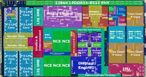

I wonder if Intel considered something like 2+10 for Lunar Lake.
2+10 sounds good but that means creating another configuration as Skymont is only quad cluster. So... 2+8.
What are the advantages and disadvantages of Skymonts 3x3 decoder vs. Lion Cove's 8 simple decoders?
The x86 variable instruction length makes it hugely advantageous to go with the cluster decode configuration.
Here's the page talking about variable length decode:
Whatever advantage a full decoder has, it's not worth it at all after certain width, especially when you consider that wide decode is for increasing the peaks, so it already diminishes the w/e perceived advantage there might be. So yes, back in the P3, P4, and Core days they were small. Now we're talking double and triple that width, which dramatically increases the complexity.
Here's a great thread talking about Skymont's clustered decode: https://news.ycombinator.com/item?id=40711835
And because it's a brand new idea, you have potentially other opportunities to further improve it, compared to traditional superscalar approach which existed for 30+ years. Kinda hard to see it as anything other than a win-win.

I wonder if Intel considered something like 2+10 for Lunar Lake. Given the huge increase in IPC for Skymont coupled with the fact that the clockspeed advantage of Lion Cove is quite small in this segment, 2+10 seems like it could have been a nice configuration and probably even a bit less area then 4+4.
Like @gdansk already wrote, given their previous config they sure did consider it. However, 4P config is much more suitable for the kind of workloads this chip will see, from browser engines to low power gaming. And again, the IPC delta between Skymont and Lion Cove does not tell you the full story:
  • Skymont in LNL runs at much lower clocks than Lion, and would also have trouble scaling without access to a fast L3
  • P and E cores no longer share the ring bus, so it's a good idea to have enough of them on each side to tackle most common workloads
The reality of the situation is we would not be having this conversation if LC was more efficient and a bit faster. I would argue 4P is a very good foundation for the 12-17W envelope. From here Intel could add 2-4 more E cores to keep scaling the design within the same TDP range (assuming the quad cluster is a limiting factor then it would be 4), or alternatively add +2P and maybe another +4E for higher TDP designs. Obviously it ain't happening this way, as we have no direct iteration from LNL, so we'll need to see how they follow up.
Personally I'm getting increasingly convinced the high performance NPUs are wasted in all the CPUs in the of this gen (in the Win ecosystem). I think we would have been fine with the 12-20 TOPS as hardware support for the fiorst generation of software. By the time we'll get proper AI feature implementation on Windows the current "high performance" NPUs will likely be obsolete in terms of performance or hardware support. In the case of LNL we could have gotten another 4E cluster if the NPU was half the size, and that would have improved performance scaling up to 28W.
The lack of a fast L3 cache hurts Skymont in LNL quite a bit, especially in FP, where Crestmont is quite weak. It seems it loses almost all of the gains from the doubled FP units.
We wondered exactly how it would perform, considering it was an improvement over LPE in Meteorlake, but the SLC is quite slow and the LPE moniker is appropriate in Lunarlake.
Yea. It's really only useful if you have a discrete GPU, like Nvidia's top end parts. What matters if you go from 0.01x of the performance to 0.05x?
They could have doubled the SLC cache to 16MB too, reduced power further and improved performance. Or 12 Xe2 cores. Heck, 2 extra Lion Cove cores! Anything really other than a honking NPU.

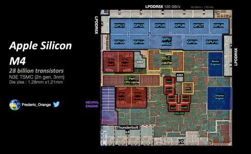

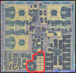

Intel's npus are too big, look at apple, it's 5-7mm2 at most on A18. Lnl npu4 isn't much smaller than the entire 4C CPU cluster. How is apple so good at designing all these IPs man... This is why Intel didn't stand a chance in the mobile market

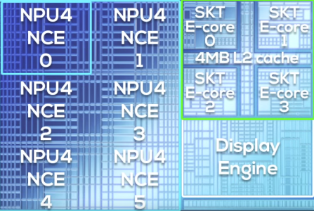

I can't see the Die Space wasted that should have been better utilized or removed to make it cheaper
Here's a simple comparison based on the LNL floor plan. Two of those NPU NCEs would almost cover an entire Skymont cluster.
Today, from a consumer point of view, the NPU just adds to the weight of the chip. MS failed to deliver anything of substance this year, and by the time they do come up with cool features we'll probably have a new generation of chips anyway. Today's chips need to have NPUs so that devs can count on the functionality, but whether they need this much NPU is debatable in my opinion (as a simple consumer, the one who's supposed to pay for this as a product). There's a high chance this hardware will become obsolete before the really good AI features come online.
I'll stop here as this was supposed to be just an observation to @Hulk 's commentary about P and E core configs in Lunar Lake... and it's borderline a rant now.
Apple is more of a hardware company than a software company, their hardware teams are one of the best in the industry. Their software is okay but not industry leading. It comes down to planning, setting achievable goals and iterating on IP every year till you mastered it.
You also have to hire the right people and manage them properly. Apple also ain't perfect they made plenty of mistakes like Intel, their car project which was the perfect case study on how not to handle a long term project. You just have to remember not to repeat those failures again.
They didn't cause they never bothered and when they bothered it was too late also
Apple and Intel's use of Libraries makes the difference as well one uses HP other uses HD apple is moving to HP Now since they have started chasing clocks
There is the point of stagnation of design team and foundry as well both were interdependent Meanwhile Apple Multi sourced and their execution ability which Intel lacked
Combining these with Apples amazing Design we get M series SOC
FlameTail
Dec 15, 2021
4,384
2,762
I doubt Intel is using HP libraries for the NPU.
Intel's NPU does support more data types than Apple's does, iirc. Though I don't think that alone explains the much bigger NPU size.
Edit: Apple NPU is 35 TOPS of INT8, Lunar Lake's NPU is 48 TOPS of INT8. So Intel does have more "TOPS'.
