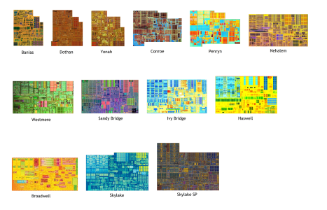

Can anyone tell me which part of Lion Cove, or any P core since Sandy Bridge for that matter was anything more than just add, add, add? Bigger units, more units, that has been the case since Haswell. Even Sandy Bridge for that matter had a core 50% larger than the predecessor. The saving grace for that chip was there were innovations and wasn't just pure expansions.
Where does the idea come from that the Sandy Bridge core is 50% larger than the Westmere core? Sandy Bridge was the first to add a decoded microinstruction cache (UOP L0), a physical register file, a 256-bit FP vector, and a ring bus.
Each generation introduced optimizations, not just resources as you say. Adding resources means new control logic and new/redesigned algorithms. It's not just an accessory as you claim. Haswell has added, for example, a new generation TAGE predictor, etc. Read about the details of changes and optimizations in the core microarchitecture. From Conroe to Skylake, resource additions were quite conservative. These were mainly optimization/reconstruction with relatively conservative expansion. Only Haswell added a fourth ALU port.
The E core team also doesn't shy away from changing things drastically. From Goldmont to Tremont, it had the L2 predecode cache. In Gracemont they took it out entirely and replaced it with the OD-ILD.
Since the L2 predecode was a rather large 128KB SRAM, taking it out was an efficient choice, and OD-ILD isn't limited by low hitrate on large datasizes, meaning it performs better. It's quite amazing to me that they took out an entire feature, added a new one while delivering substantial performance gain overall.
These are still optimizations and design choices that save or replace more complex logic. This is nothing new.
Such optimizations have been, are and will be. Now, for a given moment, one chooses such a solution and then in future generations it is changed to the previous one or even another one if it is more beneficial at a given time.
In each subsequent generation of microarchitects, in addition to adding resources, optimization and reconstruction are always used. This is not always a revolution and does not always have to bring huge profits to IPC.
Even in the case of chipsandcheese, they do not rule out that Zen5, which currently offers a clustered decoder, AMD may return to a single wide one in the future.
I got that wrong but post-Sandy were an era of disappointingly small increases. The fact that we're getting to such small improvements in Moore's Law and they would have had lot easier time back then yet the improvements were barely 10% means even in their best days the P core team wasn't anything special.
