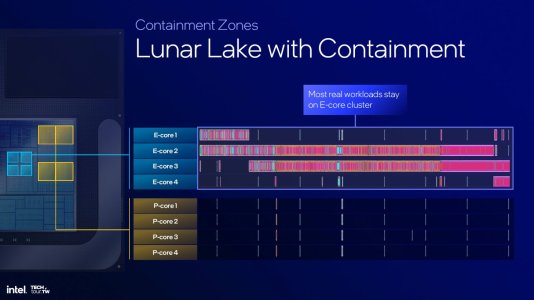

From all the sources I have seen there is no HT on ARL-S. Every source says this and we got some from Intel too. It is very very unlikely. From what we know only some server variants might ship with HT enabled.
But then will Arrow be limited to only 8P+16E=>24 threads, when even the predecessor had 32?
Ok, Arrow should still be more performant, but even so It looks like a regression.

~10% die area is committed to HT? That's hard to believe. Also the extra power consumption only occurs when the HT core is forced to handle two threads, no?
All the structures required for HT don't disappear when HT isn't active. Even if they're clock gated to avoid all dynamic power they'll still use some amount of static power.
Regarding the 10% core die area to enable HT, keep in mind that also includes the many security structures which are only necessary for a HT enabled core.
Ht enlarge structures in cpu critical paths. Removing it is much like going one node forward with manufacturing process. And yes, when cpu critical path is made larger power use stay high even when those parts for two threads aren't used. Maybe that can work around by design that has lower frequencies for SMT. Intel designs have lacked that kind of design philosophy.
Based on LNL's design philosophy, if there is busy Lion Cove frequently, that is no less than a waste of power consumption.
Intel dosen't aim at squeezing LNC performance from the start.
This is from the senior principal P core engineer and Intel slides.
HT adds 10% die area and additional power usage even when running ST.

And what exactly did he say? Arrow Lake's Lion Cove will have more L2 Cache than Lunar Lakes's (3MB instead of 2.5), that just about covers the extent of the "differentiation" between them...
if i get bored i will dig up a video for part of it: according to Intel, Lion Cove is an "architecture" (not a "Core", an "architecture") that has "many" configurable options, including hyper-threading, that can be turned on and off as needed. Hyperthreading was turned off for Lunar Lake to save area and power. They said all of this on video, I'm sure you can find it.
For the more direct answer, it is coming soon. It wasn't communicated to me in any way I can show proof so you'll have to wait (or talk to an Intel rep).
Everything I've seen indicates Intel has actually done something few (any?) companies ever have, and I don't think they are being given enough credit. Based on their claims, they have made a silicon design that is highly configurable and easily portable between nodes/processes of multiple vendors. That is, Intel can quickly spin up a chip with Lion Cove cores in it on either TSMC or Intel processes, and on either N3/N5 or Intel 4/3/20A/18A with minimal effort. They can do this while also turning on/off or configuring major features.
In lunar lake, for example, L2 cache was cut down and also L1->L2 bandwidth, hyper-threading removed, AVX--512 is "supposedly" not present, and more. Lion Cove server cores will have none of those limitations, and desktop will be optimized around whatever makes sense for Arrow Lake.
It’s 10% core area, probably not including L2 which means it ends up being like 0.3% of the compute die area for each of the four P-cores in LNL.

No Intel chip designers have explicitly stated that LNC in ARL will have HT. Some of the things they said kinda implies that ARL may get HT. Even I think it will. But Intel hasn't confirmed it yet.
And about HT, the P core designer said it in very high clarity the same thing I've been saying all along. HT kicks in and gives the performance increase only after all physical cores gets fully saturated during heavy multi-threaded workloads. And imho, this situation is not useful for most consumers and completely useless when there are plenty of E cores. HT is archaic and should just die.
