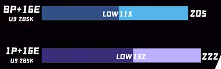

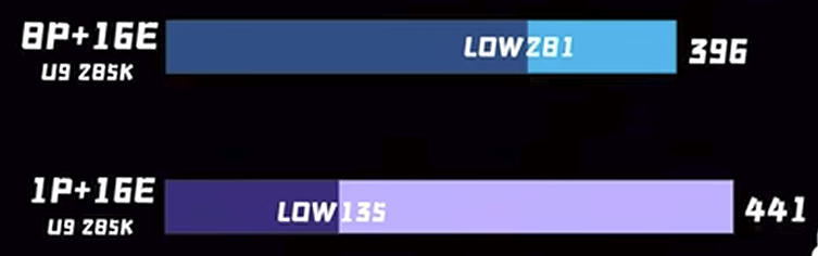

They test two games, CP2077:
and Baldur's Gate 3:
Some observations here:

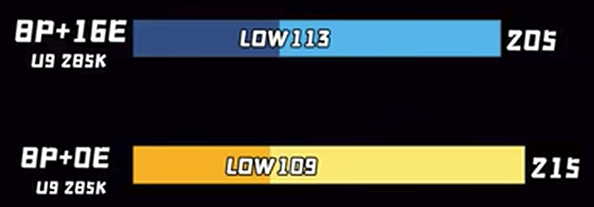

  • for CP2077 - ARL performance in this game improved drastically after the Dec 24 updates, to the tune of 20-30% depending on testing conditions (example)
  • for BG3 - the benchmark data in the review is very odd, both GPU load and power draw are significantly lower through the 1P+16E run ~10% higher FPS. That's not how it works. Baldur Gate was also another game that benefited from the Intel performance patches in Oct and Dec 24, meaning we would need to re-test performacne for both configs.

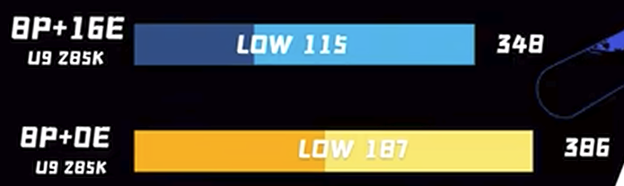

CP2077:
Counter Strike 2:
These results don't tell us much, CP2077 sees a small perf delta while CS2 is likely hard to benchmark consistently. I wish they kept BG3 as second benchmark. Still they contribute to the idea that ARL had inconsistent performance at launch.
TO summ this up, I would be skeptical that ARL 1P+16E with Skymont OC is still a better gaming CPU than ARL 8P+16E, I think we would need a proper proof with more than 2 games and updated software.
