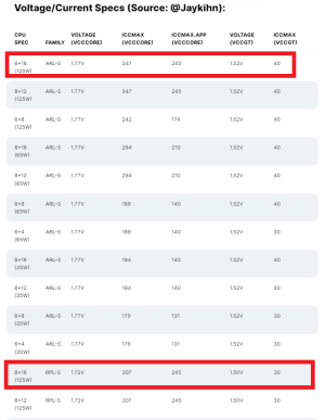

Can this be real ? 🤣
Intel Sets Higher Temperature "TJMax" & Power "Electrical DC" Specifications For Arrow Lake CPUs​
Intel's Arrow Lake & Panther Lake CPUs will feature a higher temperature limit of 105C compared to 100C on Raptor Lake CPUs.
Board makers such as MSI recently introduced a new BIOS feature called "CPU Fast Throttle Threshold" which allowed users to manually set TJMax limits beyond the official rating, up to 115C which will help you degrade your CPU silicon even faster and let you experience the joys of an unstable PC.
That’s be expected Apples TJMax is 110C on their N3B node SoC, it’s got nothing to do with efficiency but then Apple also doesn’t push 200watts.
Det0x
Sep 11, 2014
1,436
4,848
Seems like power limits also are going up.
Must say this don't fill me with confidence..
