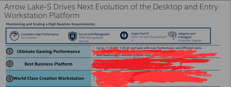

Oh, I totally forgot to come back to this.
Here. I'm not leaking anything that's new, so I've censored out anything that has even the slightest bit of being actually new information. Deal with it.
When I last mentioned that ARL may get Battlemage as it's already up & running, people said no. Many believe ARL is actually getting Alchemist+. But this slide says otherwise.
So, is this slide legit? Is ARL getting Battlemage?
Thanks for sharing. I have not seen that before. So you were talking about gaming performance. That helps clarify. Although it doesn't specify if that "perf gain" refers to IPC, clocks, or the combination of both.
Well ST gains must be a cumulative effect of clocks and IPC, or else they would specify IPC (or clock). Historically, intel used ST uplift this way, correct me if I'm wrong.
is that 1.05 over RPL-R? That puts it at +10% over RPL which still isn’t great but it’s better than nothing.

1,284
Hard to say whether it's RPL or RPL-R. Absolutely no context. We shouldn't be using this info until we have better clarity.
