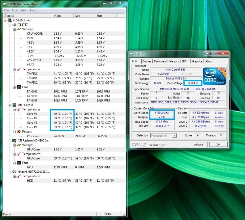

Non-overclocked Performance:
Idle - Core i7 860 with power saving technologies = 1200 mhz (133 x 9.0) @ 0.864V
Intel Stock Cooler: 39 / 40 / 39 / 40 *C (Image)
Prolimatech Megahalems: 29 / 29 / 31 / 30 *C (Image)
*Notice my hard drive and GPU temperatures did not change so the case airflow is the same.

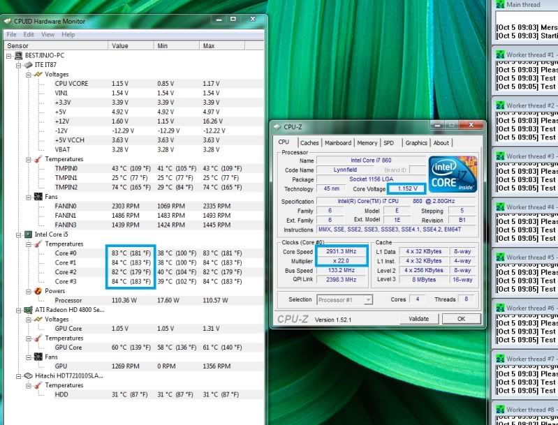

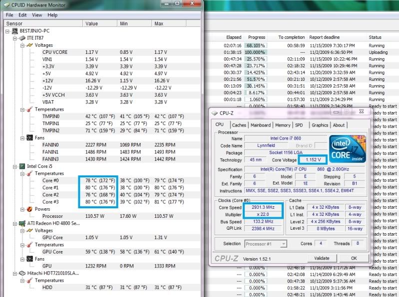

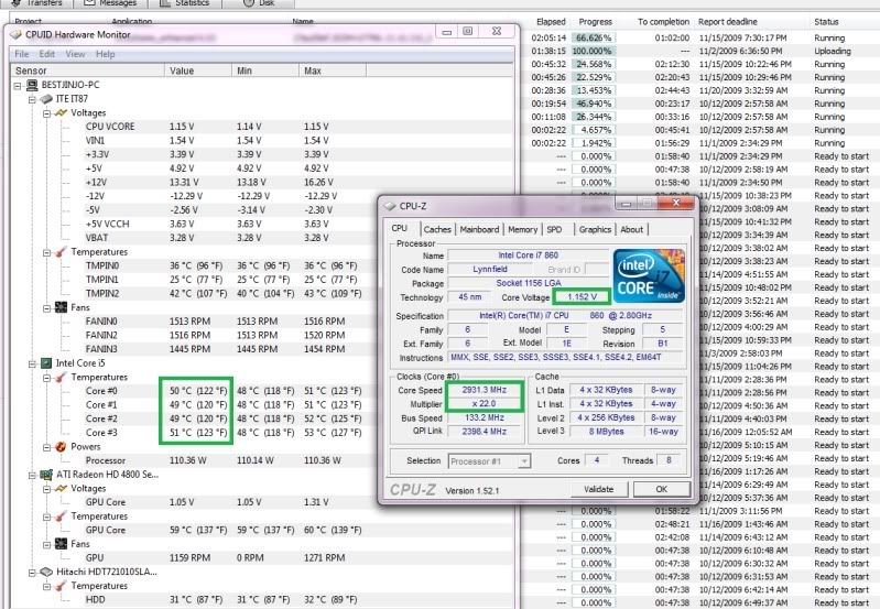

Load - Seti@Home (8 threads) - Core i7 860 = 2931 (133 x 22) @ 1.152V
Intel Stock Cooler: 78 / 80 / 76 / 80 *C (Image)
Prolimatech: 50 / 49 / 49 / 51 *C (Image)

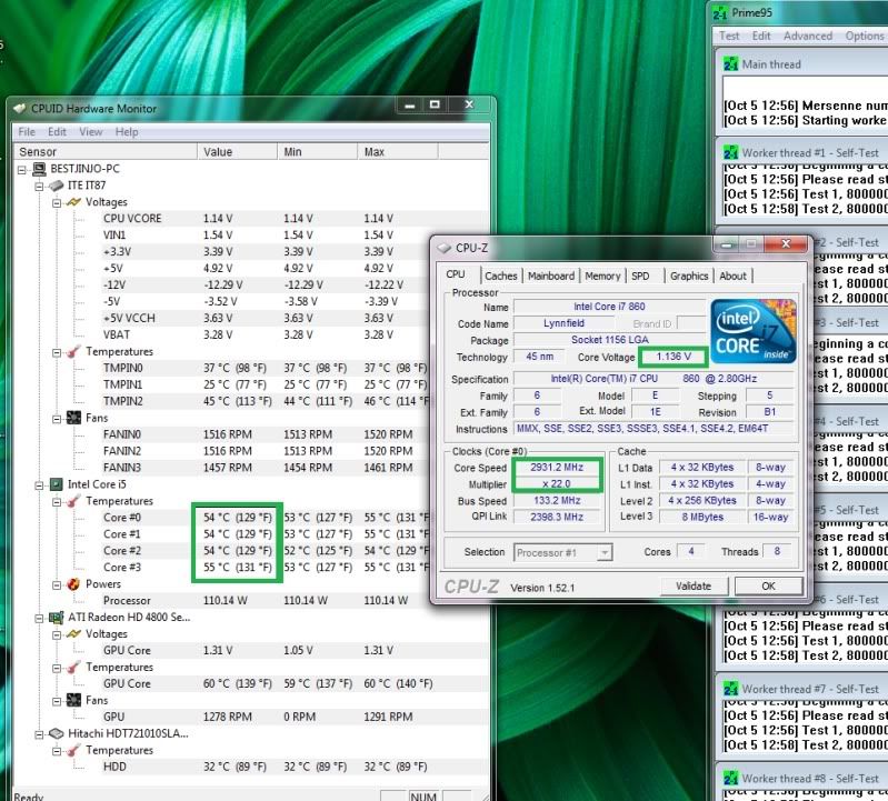

Load - Prime 95 (Small FFTs) - Core i7 860 = 2931 (133 x 22) @ 1.136-1.152V
Intel Stock Cooler: 83 / 84 / 82 / 84 *C (Image)
Prolimatech: 54 / 54 / 54 / 55 *C (Image)

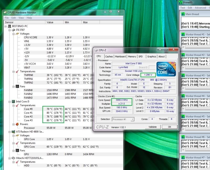

3.99ghz => BCLK 190, idle Vcore 1.2640V, Prime95 100% load Vcore 1.280-1.296V @ 76-77*C
So far passed 7 minutes, which is nothing but getting a feel for temperatures. Will obviously test Prime 95 for much longer.
My current standing after 1 hour 20 min of Small FFTs: 3.99ghz @ 79 / 80 / 76 / 80*C 1.296V
Getting Prime95 stable above this frequency needs more than 1.31875V on Vcore which takes my temperatures to 83-84*C. I don't want to run my system 24/7 under these conditions so I am limiting my overclock to 80*C.
