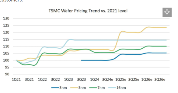

I highly doubt N5 is $16K as you claim. 2021 is a while ago, and it does get cheaper over time, for obvious reasons
$18-20k pricing for 2024-2025, claimed by source: https://www.tomshardware.com/tech-industry/tsmc-may-increase-wafer-pricing-by-10-for-2025-report
If you got better source showing that price is different then please share, all evidence from TSMC so far points to advanced nodes being charged at higher and higher prices due to high demand, plus N5 is too new for fabs to be fully depreciated (can take longer than usual due to higher fab prices in the first place).
How many times have I got to say it, that source claims 18k listed price for N4 which CANNOT be used for N5, all other sources say N5 is 16K AT MOST and multiple people have already come forward with evidence showing how N3B was discounted to below 15k$ already with a 40% discount, if you think Intel and other partners didn't have discounts on even older nodes then you are delusional.
You know what's funny too? On the same exact tomshardware article you hold as the single truth, according to their graphs, TSMC N5 and N7 are at the same prices relative to their original 2021 prices with similar increases up until 2024:
If you look at the graph very carefully you (if you are rational) may see that as of 1Q24 (the last actual data point they had) TSMC 5nm and 7nm were both around 5-10% above 2021 prices and this trend was shown to continue even in tomshardware's own projections until at least 2025. Which means that the majority of battlemage cards produced thus far have been on that old pricing. It's only after 2025 which Morgan Stanley expects a 10+% increase in N5 prices, which tbh I don't think they can accurately predict anyways. Nonetheless its irrelevant to our discussions since Intel likely pre-purchased wafers anyways regardless of whether they continue producing battlemage in 2025 or not.
Where
It's a 270mm^2 die.
He literally just showed u where... You give Adroc Thurston a bad name :rolleyes:
N5 pretty clearly going up in price faster than N7 in 2025 - so what if rate of inflation was close before, that does not mean they had same absolute prices!
And where on that chart nodes N6 and N4 if they are separate :rolleyes:
Q1 25 is pretty clearly taking off for N5, I guess if Intel stops making GPUs on it then they will be ok.
No one said they had same absolute prices but at the same time the prices are not significantly different from quoted 2022 N7 vs N5 prices of 10k and 16k respectively, atleast according to this tomshardware post you love so much.
Keep being ignorant. Firstly these numbers are all market estimations not actually prices. The prices vary from sale to sale and company to company, meaning that prices are in fact different for the exact node you are using like N3E vs N3x or N5 vs N4. Secondly if they were talking about N5 prices they would have said N5 not N4. Them saying N4 means that they are specifically referring to N4 separate from N5 as a whole.
"Pretty clearly" according to who? Morgan Stanley's market projections? The story is a lot more complicated than that but sure let's say their projections are the absolute truth. According to their projections N5 class wafers are going up by 10-15% over the next two years right? Guess what other products are also going to be produced on N5 family of nodes? RDNA 4 and Blackwell. We'll see what happens with those generations, but I'd say that blackwell isn't going to provide the low-end with any improvements and RDNA4 will have to bring a +25% price/perf increase to compete at 250$ with BMG.
That's not how it works for the likes of Intel - TSMC auctions wafers on regular basis, that's how they put in price increases (or decreases if utilisation is low), obviously they won't allow long term pre-purchases for advanced nodes at cheap price unless it's Apple level who banrolls whole new fabs.
As for pre-purchasing wafers, it absolutely is how it works. There are already numbers out there with the number of N2 wafers Apple/Intel/AMD have pre-purchased from TSMC . Arrow lake N3B wafer contracts were placed more than 2 years ago at least while the actual products released this year. As for pricing of these pre-purchased wafers, it is a lot more complicated than one singular price figure. You can't just assume just because the average sales price of a wafer goes up in year 20XX that every single company producing chips from TSMC experiences the same exact price change, if at all. The nature of these contracts is a lot more complicated than anybody of us realizes and also is confidential between these companies.
Some random market analyst from Morgan Stanley pulls out of his ass projections for markets +2 years from now -> You apply this 1 to 1 exactly to Intel even though they likely pre-purchased their wafers long before 2025 and most importantly the details of their agreements with TSMC can vary in prices by a ton -> Then you use this to extrapolate that Intel battlemage will be in the negative for each card produced in 2025 from what reasoning?
You don't even know the BOM to begin with or even the cost of a BMG die outside of rough projections. You don't know the margins from which other cards in the price point are making. You don't know the cut that the AIBs are taking. You don't know the parametric yield of the die itself. A random analyst's projections for the next 2 years is hardly from a reputable source. You don't know the specific nature of Intel's agreement with TSMC and the pricing of the wafers that Intel themselves paid for.
Do you see how many assumptions you are making?? Either way there is a pretty easy way to see how likely/unlikely it is that battlemage is losing money for each card Intel produces. If Intel continues to produce battlemage cards and continues to sell them at competitive pricing, it's highly likely they aren't in fact losing money for each card they produce.
