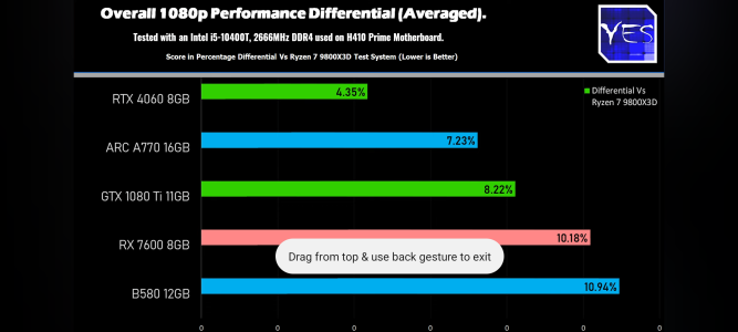

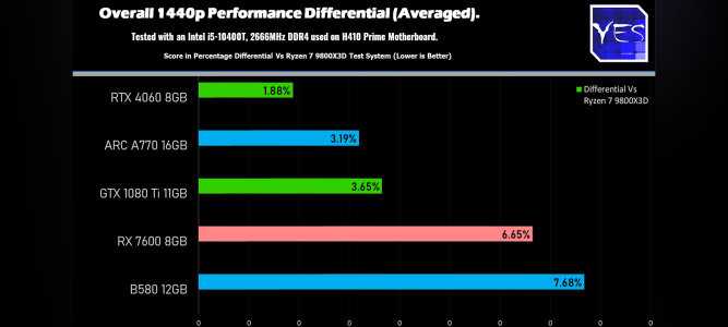

HWUB retests in a variety of conditions with 5600 vs 9800X3d:
Looked at the important parts.
Cyberpunk adjusting the crowd settings affects the performance depending on the CPU. And it seems there's a certain "cap" to the peak frames. 9800X3D shows bottlenecks he says, no surprise. You could tell simply by 1440p doing a lot better.
What I'm puzzled by is how some are saying the Alchemist was better in terms of overhead? Did I understand right by Bionic_Squash saying that the driver branch of BMG is actually behind ACM by 2-3 months and after that it'll do better?
