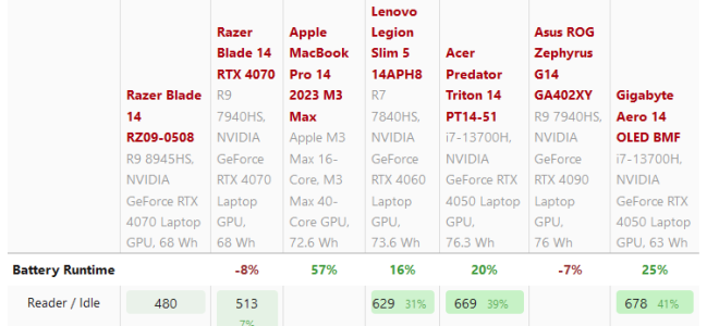

Unfortunately, the performance does not scale linearly with the power. The performance per watt ratio depends on the selected power level, and, which is more confusing, it does not scale linearly with the load.
For example, the mobile AMD Ryzen 7950HX, while being more efficient than 13900HX on the full load, has a much higher idle power consumption. As a result, the laptops with 7950HX rarely work longer than 4-5 hours compared to 6-9 hours for Intel.
28,173
19,208
Might be dependent on OEM firmware.
8945HS from Razer is BAD but 7840HS from Lenovo looks good enough. Not as horribly behind Raptor as the Razer laptop so it would seem Razer is doing something wrong.

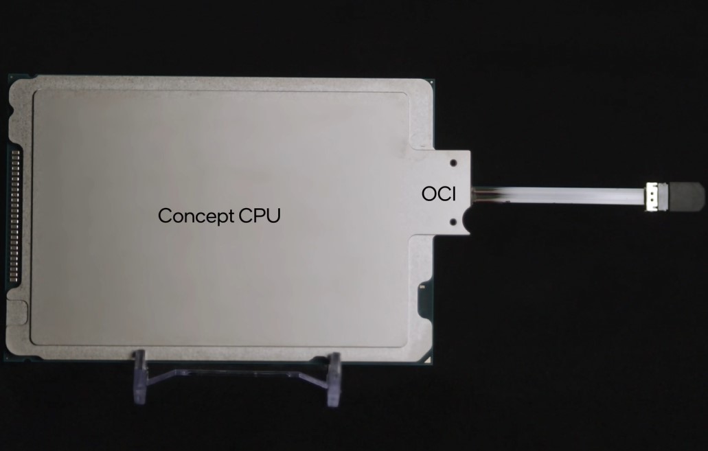

The "advanced" thing about Intel's tiles shouldn't be likely to make a difference in performance.
What I want to see from Intel (and AMD) moving to better packaging and interconnect is getting rid of the power draw tax of chiplets.
DavidC1
Dec 29, 2023
2,101
3,221
It is impossible to eliminate it completely. But it's a bigger task on GPU because it requires much higher bandwidth, and on-die will always be lower latency.
Tricks will have to be used to mitigate the effect, such as 3D stacking, which comes with it's own issues such as thermals.
