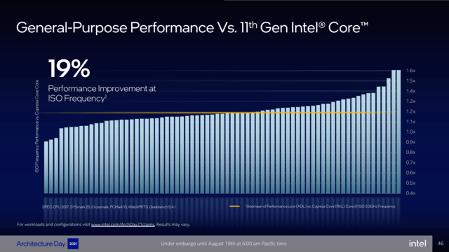

They have published the benches used, all thoses bars are due to the fact that they display all subscores of a handfull benches where there s only 3 that are relevants or so.
Based on overall scores and individual subcomponent scores on: SYSmark 25, CrossMark, PCMark 10, SPEC CPU 2017, WebXPRT 3, Geekbench 5
There s no Cinebench here, seems that the marketing trick to display a lot of bars did work, people assumed that it was the same benches than in the ICL/TGL slide...

If the IPC gain between Cypress Cove and Golden Cove is enough, possibly. Uzzi's right that it's more likely an outlier. Have to be 20% or more.
Cypress Cove does 6000 pts , with 20% more that s 7200, and then there are something like 4100 pts that should be produced by the small cores to get to the alleged 11300.
That would put the small cores at 512 pts each at 4GHz, so about 640 at 5GHz, wich is a slighly better IPC than Cypress Cove s 623@5GHz...
That s not only more that is needed, but more than more...
For 11300 the gain would need to be more than 20% yeah. The small cores are most likely only adding like 3000.
