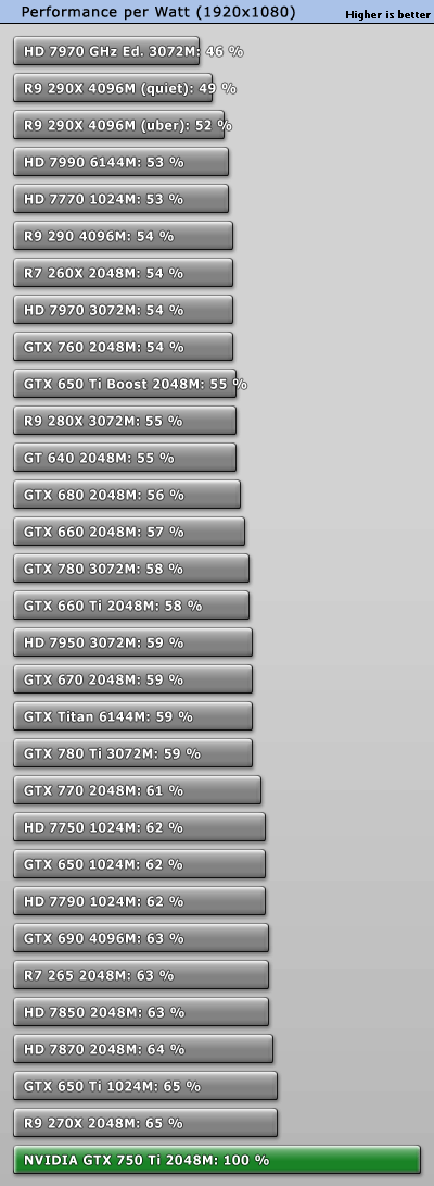

Okay, it's not 100%, it's 82%.
Given that Gen7 is a worse architecture than Kepler, 50% doesn't seem optimistic at all.
antihelten
Feb 2, 2012
1,764
274
Actually it's only about 55%.
That graph mixes power consumption from only metro: last light with average performance across their entire test suite.
If you only look at power consumption in metro: last light combined with the performance in just metro: last light, you end up with the the 750 ti being about 55% more efficient than the best Kepler card (650 ti).
Interestingly 780 is almost exactly the same efficiency as 650 ti, indicating that at least for Kepler efficiency can be kept constant even with increased die size, if the card is balanced optimally (780ti and titan aren't far behind).
Edit: Admittedly if you only compare GM107 with GK107 it's about 79%, but GK107 is not a particularly efficient card (once you have something that slow, components on the card other than the die itself arguably start to dominate the total power draw) and not really representative of what the Kepler architecture is capable of.

I have to ask where you've been if you haven't seen it.
I think it's fairly obvious that pw257008 made that statement in regards to Witekens claim of a 50% efficiency improvement for Gen8, and whilst we have certainly seen plenty of stuff that would indicate improved performance for Gen8, I don't think we've necessarily seen anything that would indicate improvements in efficiency (the stuff about DCC in the Anandtech preview, would mainly affect idle power use).
pw257008
Jan 11, 2014
288
yep. i wasn't clear. i meant concrete evidence on the level of performance and efficiency improvements (in response to witeken's extrapolations on extrapolations).
