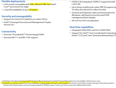

At least based on that PDF, it could be Raptor Cove, unless they have made a new die compatible with LGA1700.
It's also funny that they say long life availability but then refuse to commit. Which one is it, Intel? Are you implying here that in 10 years, you may not have any fabs to provide these CPUs?
Also, it's contradictory of them to use Core Series 2 branding for Raptor Cove based CPUs. Weren't they accusing AMD of deceiving customers with new model numbers and old generation products at one point?
This is for the Embedded market lol not for general also it has SR-IOV on an iGPU damm 😍.
