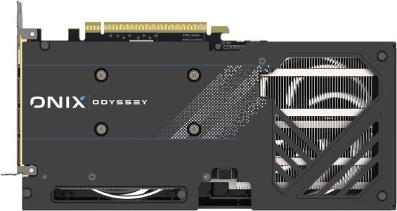

The Onix Odyssey is a solidly built card with a good metal backplate. Pic is from Newegg
It's over 2.5 slots thick. Runs quiet and the highest temp I have seen with afterburner was mid 60s. I need to add another case fan. There is only one at the moment.

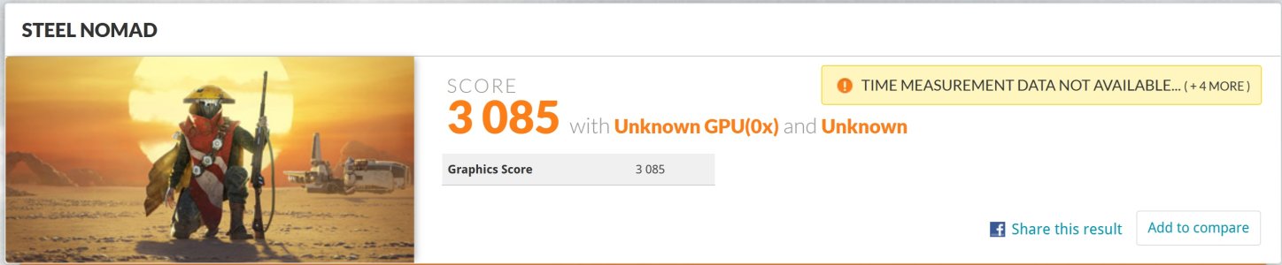

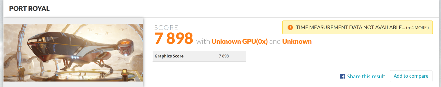

3DMark can't parse the system info; combo is too rare?
Those scores are with launchers and browser open. It is a fresh install of win 11 pro 24H2 fully updated. No overclocks or any other benchmarkers tweaks.

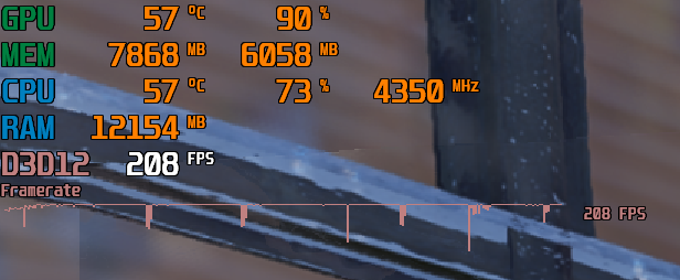

Using presentmon in Spiderman MM the GPU is waiting on the CPU a lot. VRR, FG, and upscaling make it smooth and playable but it ain't good a 5600X3D is holding it back that much.
The theory is that the fewer threads left will have more cache available to them which might increase their throughput. Each thread will also get more memory bandwidth.
That hypothesis failed miserably. It'd freeze for a full 2-3 seconds trying to swing around. Huge stutter and freeze going into a fight. Look at the frame time graph; it's a horror movie. Threads matter, it is that simple.

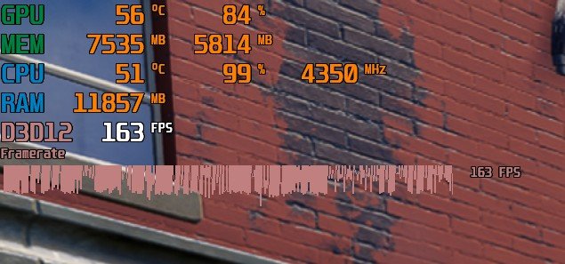

Not that I want to torture you but could you do it one more time with SMT and RT both disabled? Does that make the game playable/smoother?
RT was already disabled. Same street along Central Park swinging near the ground with SMT.

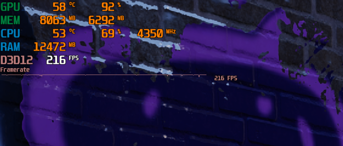

Standing still in an alley with a citizen wanting to high five me
Without the hardware Oodle Kraken decompressor on the PS5 the CPU is pulling that load. Compound that with the driver overhead and 6 threads ain't cutting it.
