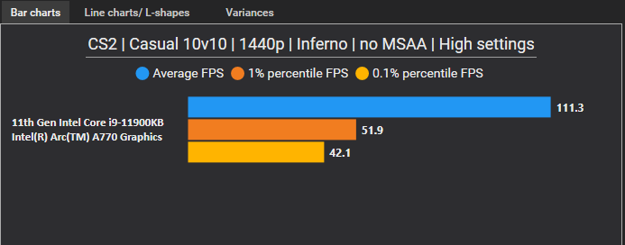

Not sure if anyone here has posted any CS2 benchmarks but I got access recently, been playing quite a bit. So decided to do a quick test on the A770 on inferno, the most demanding map in the game so far. 10v10 players. I usually play comp, 5v5 so alot less going on and feels alot smoother. When I am playing comp again I will benchmark that. 1694047108166.png
DAPUNISHER
Aug 22, 2001
32,011
32,461
Added your results to the OP. Hope you don't mind.

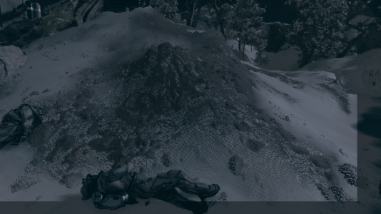

Starfield tested with dIfferent config from OP.
5700G
ASRock B450ITX/ac
2x8GB 4133MT/s
1TB nvme
Latest BETA drivers
win 11 pro fully updated
Game pass version of game
Crashes until I got the settings dialed in. They can be found in the OP. Played at locked 30 but some dips below even with super craptacular settings. Stopped playing when it crashed after almost 2hrs. Played through the Mantis mission and cleared out abandoned mines and factories on other planets.
Had a few rendering issues too. Don't know if it was due to the super low res being upscaled or driver issue.
Prepare your eyes, it's bad
I will try the XeSS mod to see if it can at least help with quality of upscaling. Who knows if it will be even less stable than FSR.
