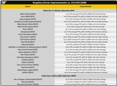

But why not for Meteor Lake Arc graphics? Meteor Lake driver 5122 is dated from late November.
That certainly is odd. Maybe they are pouring too many resources into supporting the Claw?
There are some games that need fixing so the sooner the better. There were multiple titles tested that either crashed or had serious rendering issues with the base 125h in the Acer Swift Go 14 -
Though the performance in most of the games was surprisingly good considering it's a thin and light notebook.

31.0.101.5186/31.0.101.5234
MTL driver build also did change, videocardz initially wrote 101.5186_101.5122.
