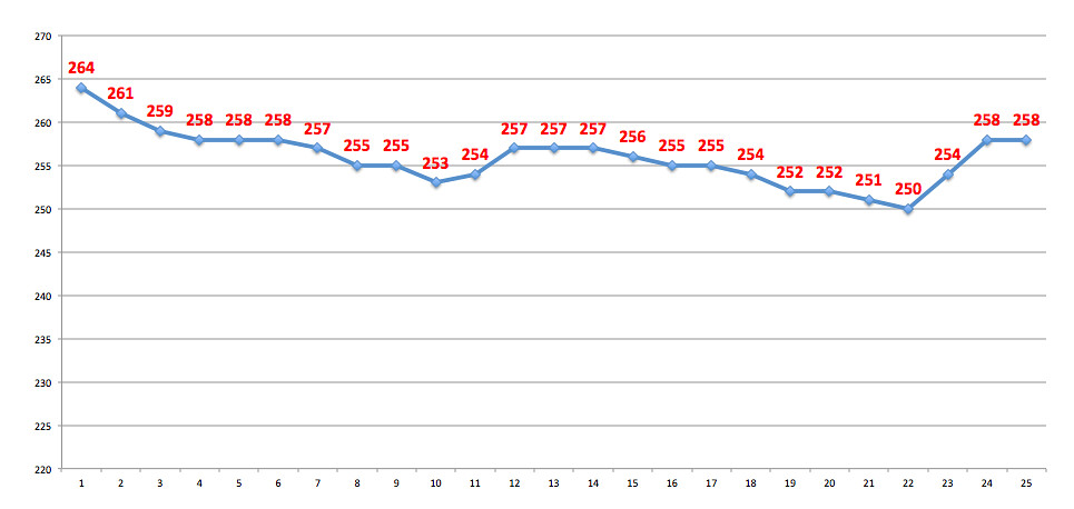

I’m not familiar with NBC testing but it is a synthetic load. How extreme is the load? Like I said, with my YES x 4 testing I could get the machine to go to 2.6 GHz immediately, and the i5 and i7 behave the same way. But YES x 4 isn't very representative of real world loads.
The graph below is our testing on KBL MacBooks, using repeated Cinebench R15 CPU benches. As soon as the test ended, it would be started again, maybe with a 1 sec delay. Wood is on a wood table (insulator) and granite is on a granite counter (better conductor). The Cinebench scores are shown in the graph lines. The X axis is the run number. After about run 10-12 runs we’re already past the 30 minute mark. Regardless, you can see there is still at least some difference after half an hour of sustained Cinebench R15 load.
For the granite run I actually ran it ran it much longer, but during run 11 I moved the computer over several inches, just to make the positioning on the counter less awkward.
Notice how the score improved when I moved it, presumably because that part of the counter hadn't been heated up yet by the computer. And then in run 23 I moved it on purpose to confirm that hypothesis.
That's less than a 5% difference.* That kind of difference can be easily dwarfed by real world factors like ambient temperature and background applications running. Macbooks also use a 7W cTDPup for the Y chips it uses.
So pretty much in a best case scenario, we see a 5% difference between the cheap M3 part and the pricey i7. That's why I am saying Y chips are crappy, overpriced chips. Either they need a purpose designed part, or I hope Tremont is 30-40% faster than Goldmont Plus and replaces them.
*If you compare the i3, i5, i7, there's a real difference on the 15W chips. The i5's are 15-20% better than the i3, and the i7s are an additional 5-10% better. So there's a reason to get the i3 rather than the i5. Turbo actually means something.
