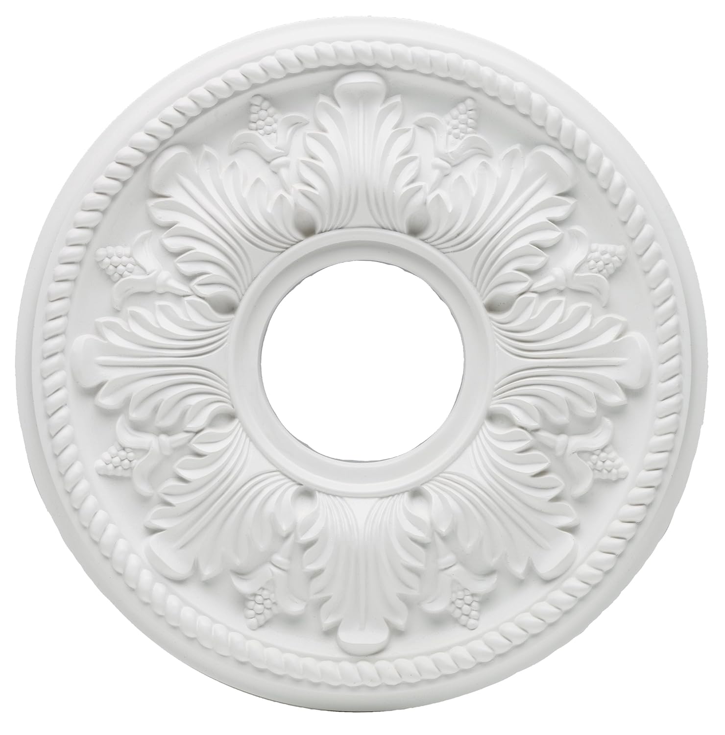

If you do end up cutting into the ceiling, instead of trying to replicate the pattern you could put a decorative ring around it, like this:
iu
Idealy you don't need to make a hole any bigger than 16" between two studs. Then you add 2 16" 2x4 cross braces and the wiring box can be in between. That should hold pretty well. Be sure to properly tape up the vapour barrier when done. It is kinda tricky to do from that side. Hopefully it's batt insulation and not blown in only.

You can enlarge the opening to the attic in the direction that the joists run - one dimension will still be 14", but you can make it 14x24 or something that you can fit through. Cutting into plaster and attempting to match a pattern? VERY difficult, imho.
You sure it's not a drywall ceiling? (Drywall can also be easily finished with a texture.)
Also, if you opt to make the attic entrance larger, and the attic hatch is also finished to match the ceiling, it could be a little difficult to get it to match, particularly if you've never done it before. But, that's the way I'd go to do the wiring. IF it's plaster, then be willing to use one of those medallions to cover the ceiling where the ceiling fan attaches, because no matter how carefully you cut through the plaster & lathe or whatever backer it has, there's a decent chance of chipping/loosening plaster beyond where your ceiling fan will cover. E.g.,
