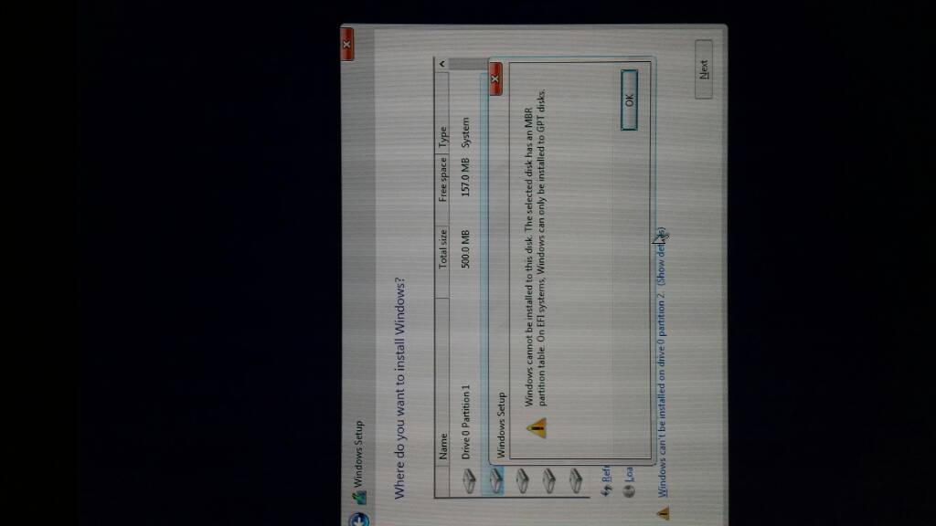

Guys I'm stuck at this error. I realise that this is due to different BIOS settings but I don't know how to change anything, I mean where to change the BIOS settings to legacy only mode! Any help?

You may need to use Diskpart to 'clean' the disk. That WILL ERASE IT.
Or, disable UEFI booting in your BIOS. It appears that your existing disk is MBR, and you booted your install media with UEFI.

Okay, thanks, yeah, I figured it later, disabled UEFI and all is good. Now setting up Windows 10. I'll come back tomorrow with an update.

Thanks. I'm not even sure what all these are UEFI, Legacy and all that! But is it right that to be able to install Windows in UEFI mode, my hard drive needs to be formatted in GPT mode? Instead of MBR? If so then kindly tell me how to format the drive in GPT mode, I'm sure an app is needed, so which one?
I recommend backing up all your data, boot the windows 10 installation and simply delete all the partitions away so the drive is totally unformatted. Then just create new partitions. If it's a system drive, just highlight the unformatted, unpartitioned drive, and click next when the install process wants to know which drive to use. If your BIOS is in UEFI mode, you really don't have to worry about anything when you're starting fresh.

Yeah thanks, did it yesterday. Basically I had to format the drive in GPT mode, as it was in MBR, UEFI wasn't able to flash Windows on it. Also I will be getting an SSD (again), and use it. But the only reason I was waiting because I thought the price of 1 TBs will come down next year or something, but just gonna get a 512 GB now.
