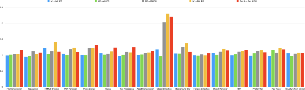

Taken from macrumors.com forum poster.
Zen3 to Zen4 had similar Object Detection gains.
Are Zen4 GB6 ST speeds valid?
Reactions: Orfosaurio
Read the thread again it's all been said.
Zen 4 is still only on par with its competition, Raptor Lake, in that subtest. Both using 256 bit vector operations.
SVL for M4 is 128 bits and the ZA size is 128x128 bits and it can do that far fewer cycles. So it ends up twice the score of its competition overall. Cool, but much more niche.

Um... so what's your point? x86 Object Detecton is valid but not M4?
Object detection makes almost no difference in the comparison between Raptor Lake / Zen 4 / M3. They're all on par.
M4 object detection is twice the score as all of them. So now it's an issue because now it makes a difference and it is implemented using an even less applicable extension (where 80% of the instructions are for workloads most software will run on the NPU anyway).
And people have been complaining about GB6 since its release for numerous reasons. But I'm sure this is all lost on you. GB6 says M4 is 50% faster than M2 in ST. This is good, Apple is good, so GB6 must be good. Nevermind that it doesn't agree even with Apple's own claims.

How can we be sure that Apple's SME implementation isn't tapping into its NPU?
Probably because that'd be much slower because you'd be moving data off the CPU caches?
Quite easy to tell when M4 makes it to Macs. Just run powermetrics and see if the NPU uses more power during the test.
It's almost certain that Apple repurposed their AMX coprocessor into SME.
Has Apple released this information? AMX was 512-bit, it would be very interesting if they went with a smaller size for their SSVE implementation.
GB6 ST improvements from M2 to M4 are pretty much consistent with improvements in individual subtests. It's roundly 40% higher ST score, and individual subtests are between 20% and 50% faster (with Object Detection being an obvious outlier). The aggregate ST score is not as sensitive to individual subtests as some claim.
I don't know, by using common sense and understanding of how CPUs work? I mean, how do you imagine them doing something like that? If they have figured out how to hand off CPU work to a completely separate IP block with ultra-low latency, then their design team is truly unmatched. I just don't get it why you worry about Apple running some CPU code on an NPU but disregard the possibility of, say, Intel running some CPU code on the GPU. It's the same thing after all.

Is Intel running some GB CPU benchmark code on GPU? Any link/URL?
I do not understand the question. Do you have any evidence that Apple is using the NPU to accelerate Object Detection? Or at least an explanation how this would be achieved technically?
I just want to know the real reason for the Object Detection test's "anomalous" result. Apple didn't announce SME. GB6 updated their test suite with SME support just before the M4 reveal. So everyone is assuming that Apple is using SME.
Apple did not announce SME, but the GB6 code contains an SME path and uses run-time SME feature detection on Apple platforms. Besides, OS experts have found evidence of SME in the iPadOS images for the new iPad. I think at this point it is fairly safe to assume that SME is there.
If they are, what kind of acceleration is GB using for Intel/AMD SoCs? If the test is properly accelerated for one CPU and not others, is that fair?
GB6 is using AVX512 with ML-focused extensions, as well as Intel AMX on supported hardware. It is up to the manufacturer to decide which of their products support their own technologies.
And regarding "fair": what is it that you want to measure? Performance of specific subsystem (e.g. integer, floating-point, vector, cache, memory), or performance of a specific application type? It's not like GB or Apple are cheating in a test. There is no magical "accelerate Object Detection" hardware feature. If Apple has implemented new HPC features that can among other things make this subtest faster, isn't that indicative of the processor performance capability, and isn't that what you are interested in knowing? Or do you only care about old/legacy code that cannot use the new IP blocks (but even than old code might use a framework that can benefit from new features). And so on. I think if one is clear about all these things, the problem of "fairness" disappears, and you are only left with the problem of choosing what is relevant for you. And this is not just about SME or Apple. Would you dismiss technologies like AVX512 or crypto instructions because they are implemented in an asymmetrical fashion by different vendors? Or would you dismiss raytracing GPU tests because some vendors have better implementations? That's up to you to decide.
Shouldn't it be their responsibility to ensure that all CPUs are being used to the best of their capabilities? Or should they just take "under the table" gifts to include acceleration for one CPU and then wait for gifts to arrive from the other CPU vendors before bothering to include relevant acceleration for their CPUs?
They absolutely do that. GB6 supports newest acceleration technologies for x86 platforms as well. I also don't really see why it is fair to penalize Apple who give you a state of the art matrix coprocessor in a tablet just because Intel has decided to cut AVX-512 from their consumer CPUs.
