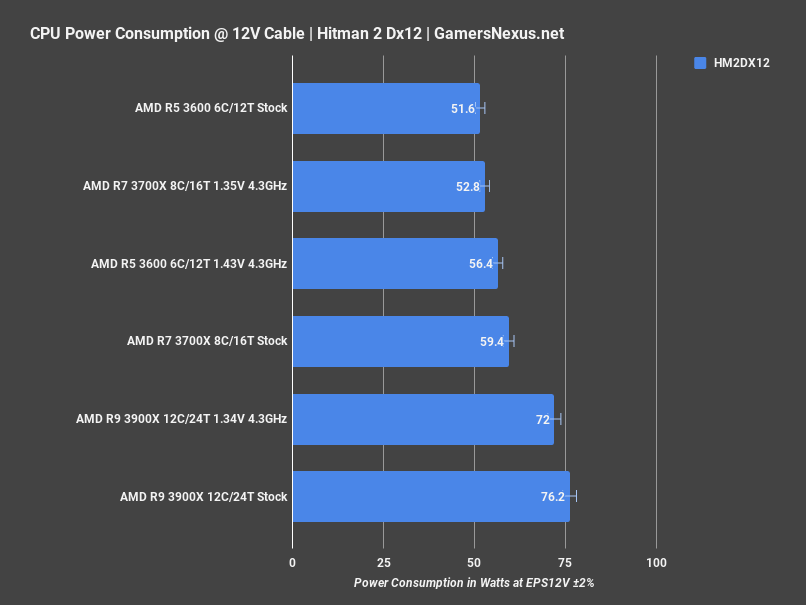

Question If the 3700x, 3800x, and 3900x have very similar game performance (FPS measurement), does that mean they are consuming the same amount of power?
leepox
Jul 21, 2020
9
36
To get to a certain level of performance, in theory all of the above will consume a similar-ish amount of power to get the same-ish gaming results right? Maybe apart from the 3900x which has two chiplets.
I'm sure cinebench/etc. it would be a different story when all cores are synthetically maxed out. But for gaming purposes, I assume it would be negligible? It's just that I'm worried my current cooling set-up is inadequate (currently have a 3700x which doesn't boost beyond 4Ghz so I'm selling it), and upgrading to a 3900x would be a big mistake in terms of thermals and power.

There's going to be variance game to game but they're going to use well under the typical stress test measurements for CPUs. Reviewers should be testing power consumption under more scenarios in my opinion. But since they don't there's more limited data but here is some -
CPU only test measurement -
System measurement -

I swear I've been looking for benchmarks on the net, how you found them, I have no idea... I must really suck at google :oops:
Thanks for these, exactly what I wanted to see. By the looks of it, 20 watts more than the 3700x under normal gaming scenarios. I guess that is the penalty to pay for better minimum (1%) fps perhaps, and maybe an extra few frames every now and then. Perhaps better higher sustained boost clocks as well?
Surprised how it's on par with the 1700x (which I also had). I guess that answers the question, my 240mm AIO should be enough to keep it cool for gaming. Quite interested in seeing how much improvement it will give for video encoding, and I think even then, it won't maximise all of the CPUs. I really need to buy a power plug meter.
Interesting that Intel's much maligned high power consumption is essentially the same as Ryzen in actual real life gaming.
That is the whole system power including most likely a 2080TI, unlike the 10900k that uses 250 watts all by itself.
While the 10900k can use a lot of power when running full out, there's no game that I know of that will tax the 10900k anywhere near full load. Most games today still really only use about 4 cores / 8 threads although 6/12 is starting to become more common among modern engines. When only loading ~ half the cores and even then there's a lot of up and down usage, the average power use of the 10900K will drop dramatically. Same for the AMD chips. This is also a two edged sword though if you want to buy a 10900k for gaming because you are just wasting money. The 10600k + overclock will actually outperform a 10900k (without overclocking) in today's games and basically match it when both are overclocked. So what's the point of buying the 10900k if all you care about is playing games today?
If we start to see games utilizing 8+ cores + SMT in the future, I would expect that you would see more separation between CPUs based upon power consumption and obviously a much larger performance lead for CPUs with that many cores or more.
What I was tryi ng to get through to ondma, was that a 10900k will use way more than 72 watts when gaming at full tilt. I will guess 150 ?
I would actually be surprised if it's 150 W. Most games do not stress the CPU very much. There are a few that might start to get close to 150 W (speculation) but it wouldn't surprise me if most don't.
Maybe 110-120 ? I just know it will be considerably more than 72.
