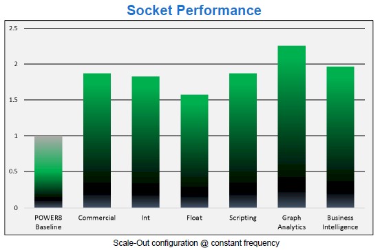

Being serious, the engineers working on this are amazing. How in the world do you get close to twice the performance than previous gen. at the same clock when you are at such a high level already?
As impressive as it is they made the comparison to a previously under-performing SMT8 mode that's why they got such a huge speed-up. Even so I'm still mighty impressed. It's going to trash Intel Xeons performance-wise. Even power8 chips are still very competitive with Xeons with twice the number of cores that were released two years later that's because power8 chips were made for very high dual and quad threaded performance(2nd thread brings 50% more performance and 4 threads about 100% HT gain is around 20% in Xeons) but 8 threaded mode seemed to be not quite done.
It seems now even SMT8 gets enough resources.
The SMT-8 mode can sometimes be a step too far for some applications, as 4 threads are now dividing up the resources of each issue queue. There are more signs that SMT-8 is rather cramped: instruction prefetching is disabled in SMT-8 modus for bandwidth reasons. So we suspect that SMT-8 is only good for very low IPC, "throughput is everything" server applications. In most applications, SMT-8 might increase the latency of individual threads, while offering only a small increase in throughput performance. But the flexibility is enormous: the POWER8 can work with two heavy threads but can also transform itself into a lightweight thread machine gun.
Yeah 24-core Broadwell is going to be severely outperformed if this monster delivers.

This Power to Power comparison likely compares SMT8 Power8 versus SMT8 Power9, accounting huge SMT yield increase. Not that is not incredible to increase performance by this margin in just two years.
