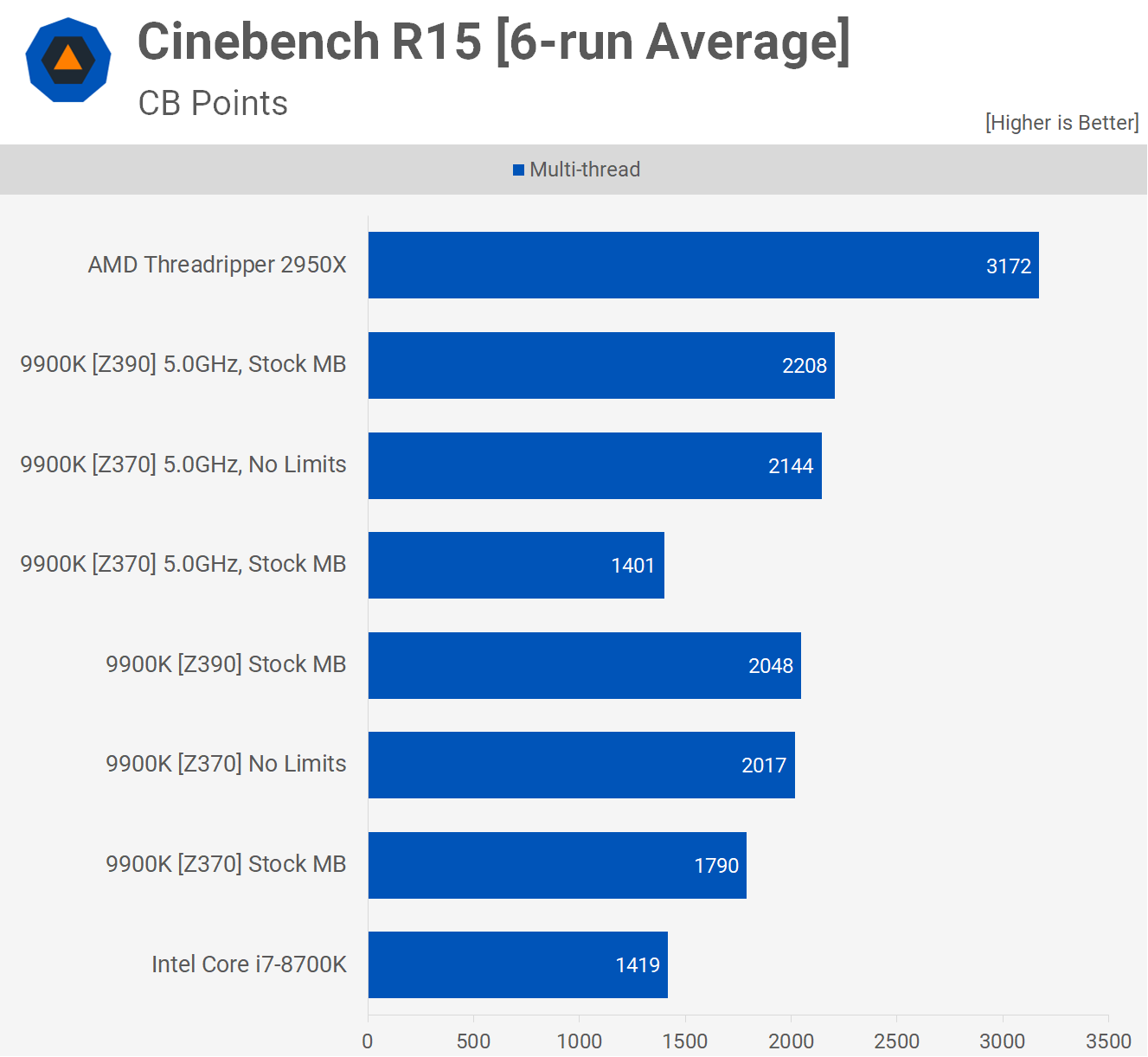

Hardware Unboxed (Techspot) did a test on a lower end Z370 board and found major power throttling issues. If they disabled the power limit, performance pretty much matched the top of the line Z390 board. https://www.techspot.com/review/1730-intel-core-i9-9900k-core-i7-9700k/page5.html
It seems power use will be highly motherboard and work load dependent.

I'd imagine they come from the different motherboards and the different methods used to measure the power consumption.
According to Intel specs these CPUs should have PL2 set to PL1 * 1.25 (== 119W), not 210W like some motherboards configure them.
Well that would also explain the high perf seen in the AT review. There is no free lunch here.
Imo it makes sense to configure this cpu with high pl2 for it's intended market. If you buy this cpu you can afford expensive cooling no probs. An air dh15 can handle it fine. This cpu is about raw perf.
