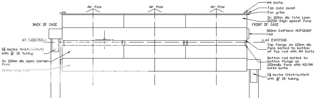

Aigo, just out of interest can you stack rads on top of each other, something like this?
Yeah, I'm a hack, I admit it. :laugh:
Stacking will work, basically this is what I did with that case but the rads are not together. I have air coming in the rad on the bottom and out the other two. Use rads with few fins per inch like the TC, Feser or XSPC (which I just ordered 2 with the paint disclaimer:Q that I didn't need!) and fans with good static pressure. I'd be inclined to use push - pull with a third fan in the middle, all three being the same fan, maybe yates. I don't know, just random ideas floating around in my head and when they bump into that last brain cell they sort of just spew out.
ROFL. I have that feeling quite often.
This was what I was planning to do, but instead of the rads/fans being on the outside of the case as shown in my previous sktech, they would be inside.
btw the top 360mm long rad and fans are already installed, so I would essentially be adding to whats already there. What do you think?
