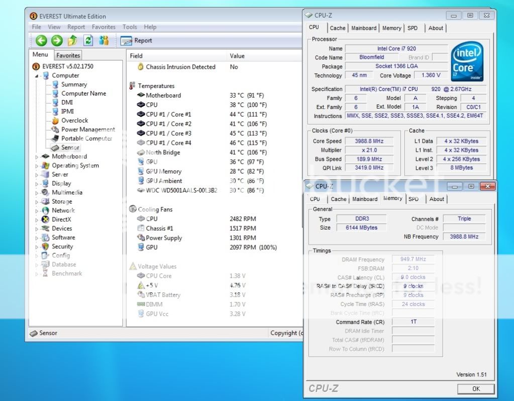

I don't see that anywhere. Here's a screenshot of CPU-Z, HWmonitor, Real Temp and Everest Ulimate (trial) running.
http://img193.imageshack.us/im...7848/screenshotqcs.jpg
Hehe, in CPUID HWmonitor it's under DRAM. So it is actually set to 1,7v. Did you save the bios? Did it not revert back to auto or 1,7v on it's own accord?
Oh, and shame on you for using IE. For god's sake, at least use FireFox or perhaps Chrome.
LOL. I have Firefox installed....but I have a habit of clicking on the IE icon because of work. Shame on me!
Yes, I'm positive I saved bios before exiting, and when I go back to check, dram bus voltage on the bios is set to 1.50V.
So I'm not going crazy... it looks like something is wrong?
In your picture, Real Temp shows "Core i7 920 4478.44 MHz 169.00 x 26.5".
26.5 multi? Mine only goes to 21 on turbo.
