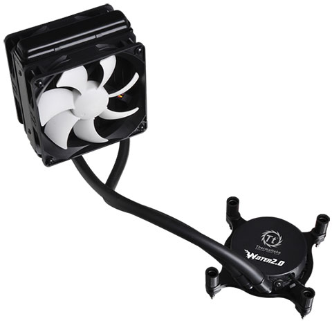

Is the H80 part by part. Now adays all companies including Corshair are selling the all in one water cooling where its 1 part. you never have to change coolant or maintain. pump on top of waterblock like mine. and rubberized couple inches only to a RAD with 2 120mm fans blow out but at 30 percent very quiet,,,,
Corshair makes the same thing I have just their own style. and Tt sells them. 100 bucks... no need for resevoir, and no tubes everywhere no leakage ever, no change of coolant,, these are quiet nice
