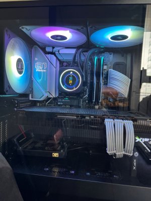

Shouldn't I still try moving the two fans at the top after removing the top glass to see if it improves airflow?
I’ve seen a lot of posts saying that AIO coolers can degrade after 5 years — with issues like bubbles or dirty liquid inside. Isn’t it possible that this could be the real problem in my case?
I’ll do some tests tomorrow and get back to you.
Also, wouldn’t it be better to switch to an air cooler to avoid those kinds of issues (bubbles, liquid problems, etc.)?

Removing the top glass panel (that's blocking the airflow passing through the radiator) should massively improve the performance of your AIO cooler. This should be done before considering any other upgrades. If it doesn't improve after ditching the glass, than it's probably time to replace it.
An air cooler will be more reliable than an AIO. There isn't much that can go wrong with an air cooler beyond getting clogged with dust or the fans going bad. The Phantom Spirit is a newer model than the Peerless Assassin. It offers slightly better performance at a similar price point. That being said, a major reason these coolers get recommended is they are $35-40 USD. There are other good and affordable air coolers that may be a better value in your region.

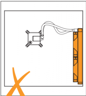

You have 2 options. If the fluid pump is not working, can repair that
OR
Buy a heatsink. Even if the fans both die, it still gives quite a bit of cooling
I recommend option 2

My system is actually this one but my radiator barbs are higher than pump head than in this picture and no issues.
Alot of good suggestion in here so far should be easy for OP to fix.

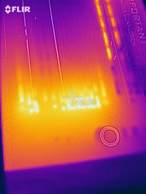

I bought a skytech gaming system back during covid to get the video card. I think it had a MSI MAG CORELIQUID 360R. (skytech rebranded it poorly with stickers) I took the video card put a ok video card in it and gave it to my niece. Well it sucked and was slow. Turned out the rad was blocked.
I had to jump through hoops to make them send me a new rad.
I even broke out my thermal cam to prove it to them. Here are the pics
Edit: I think i determined that the rad wasn't blocked but rather the chamber that sends the water through the rad was breached so the liquid was never going through the rad.

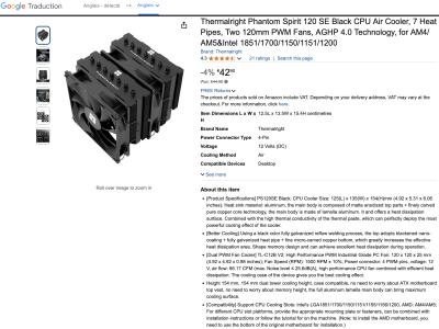

thanks for the edit
Finally I bought this one yesterday (see below as well) .The version is ok right ?
I will receive it tomorrow and I'll come back to you
I bought the fan screws you mentionned too

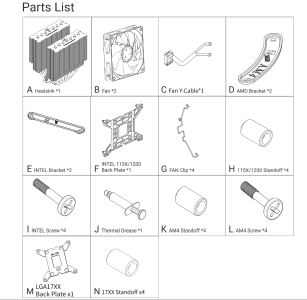

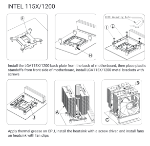

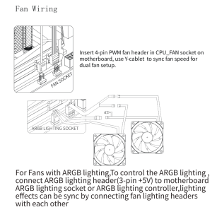

Yes, that should work great. Hopefully your case has an opening in the motherboard tray so you don't have to remove the motherboard to install the new back-plate. An opening in the motherboard tray has been standard on most cases for quite some time, so hopefully this isn't a problem for you. You might consider taking the back panel off the case before it arrives so you know what you are dealing with. Installing the cooler isn't overly difficult assuming you don't need to remove the motherboard. Just take your time and be careful while doing the installation.
I took the liberty of screen shoting the relevant diagrams from the installation instructions. The instructions are included in package, but they're in very small print, and difficult to read.
Screenshot From 2025-04-20 23-15-39.pngScreenshot From 2025-04-20 23-15-14.pngScreenshot From 2025-04-20 23-29-46.png
