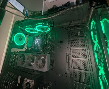

About the pump orientation: I’m not totally sure if the tubes are positioned correctly. You mentioned they should be facing downward, could you take a look at the last picture here and tell me if it looks right? . If not ok, how I can change it ? (I'm a noob ^^)

So the radiator is at the bottom of your case? If so that's not ideal. The pump is located in the portion attached to the CPU. That should never be the highest point in the loop on your AIO. Air can get trapped in the pump. Technically your hoses are the highest point but still not great.
Is it possible to turn the case upside down for a quick test and see what happens to your temps?

Before trying the changes you suggested, I realized that the computer was mounted on the wall by the previous owner, and I think it was placed upside down (with the bottom facing up). Do you think I should move it to the floor in the correct position? If you think I need to rearrange any parts for better cooling, could you guide me on how to do it? I'm a bit of a beginner, so I’d appreciate the detailed steps. :)
If the position is fine as it is, I'll go ahead and try your suggestions.
Here's a picture of my complete setup:

Yes, turn it over! And let us know if that changes anything.
aigomorla
Sep 28, 2005
21,108
3,631
Here is your problem
Provided your pump is not dead from being run dry for so long, its not circulating enough water though as a air bubble can be stuck inside the pump block
The radiator barbs, or where the tubes come out, always needs to be at the highest point in the system, to prevent a bubble being formed at the cpu head.
EDIT.. wait is your case flipped upside down? meaning you have the wrong orientation?
Reactions: bba-tcg and Rigg
I believe the case is upside down after looking at the pic long enough.

I tried to upside down the computer and now the computer is like that (there is a glass on the top fyi) :
I launched the game returnal again and i have these Hwmonitor & Hwinfo64 show me that it's 100°C again :( (sorry it's in french) : . When i'm just on the web browser i have 55-65 °C
You should not be at 65C with a package power of 20-25W. There's something else going on here. If the PC has been on for a while with that glass on blocking air flow across the radiator it's possible the liquid has saturated and needs time to cool down.

Take that glass panel off, your starving the radiator of air.
The radiator should not be obstructed, and should always be allowed the coldest air possible though it.
You might be better off just remounting it to the side next to your motherboard at the very top 2 fan mounts.
