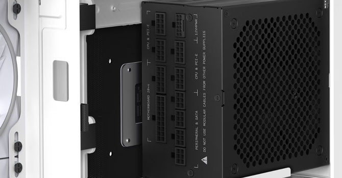

PSUNZXT C1200 GoldCorsair AX1600i

  2. Is the PSU undersized? As I ran Prime and Furmark the power consumption reached above 1000Watt.

1. It may be a Windows 11 issue. Windows explorer is MUCH less snappy on my Win11 install than my old Win10. I assume you mean folders/files on the local SSD's and HDD's (not network drives).
Are you using intel's chipset driver or the one on the ASUS website?
2. Your PSU is perfectly adequate from a wattage perspective. The review for it on TPU is good and it uses high quality components and has good efficiency at a range of power uses. (the only highlighted issue being short hold-up time which is mostly a non-issue.)
