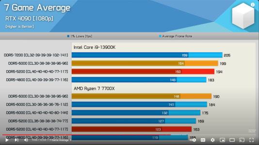

Technically even 5200MHz is an overclock. The reason you don't see a lot of kits for 5200 is because all of the evidence has shown that 6000 is the sweet spot for Zen4. There is no reason that the 7600X shouldn't be able to handle it. My daughter's 7600X runs 6000 CL30 without any issues. My 7700 also does. I've had it run at 6200 too but didn't see any performance gains so I dropped back to 6000. Look at the performance difference seen here in gaming with various RAM speeds and CAS latency.
While 5200 does show some performance increase 6000 with lower CAS latency really should be your target.
But if you still decide to run at 5200 you can turn on the XMP/EXPO profile to load the parameters and then you can manually set the speed to 5200 in the BIOS. Only takes a few seconds.
