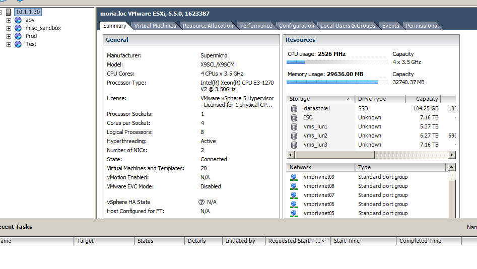

1) ESXi. I eventually want to switch to kemu/KVM as it has more features but it's much more complex to setup.
2) Only one host at this point, since free ESXi does not support multi host environments
3) I don't recall the exact specs off hand but it's a Supermicro Xeon based server that's a few years old with 32GB of ram. it's a decent box but nothing super crazy.

2) You can run multiple hosts on free ESXi, you just don't have vCenter for centralized management.
3) Specifics would be good if you really want to try to dive into this.
4) Personally I'd recommend buying a switch and NIC's to dedicate to storage to completely isolate it. Nothing fancy, just a simple managed switch and some decent surplus NIC's.

12) What build of ESXi are you running?

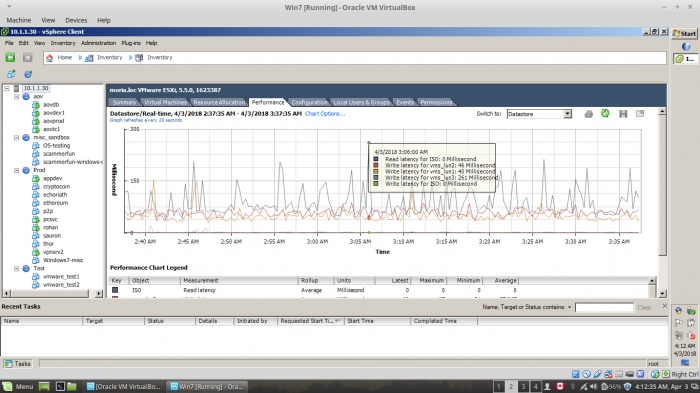

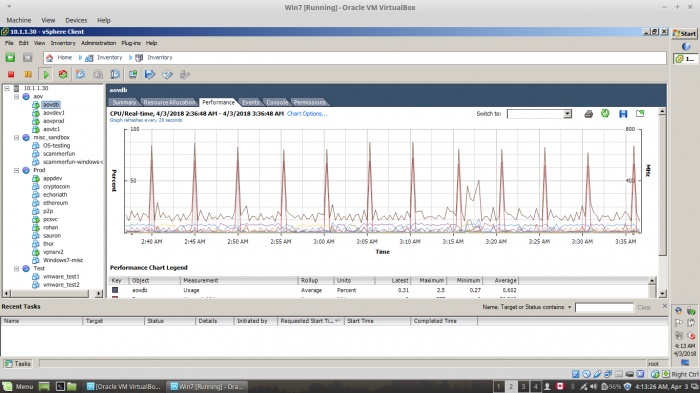

I'd recommend investing at least time if not some money into getting a monitoring system running. I don't have personal experience with this other than I know it's free and built on Nagios: https://download.centreon.com/
Also, post the disk latency numbers being reported by ESXi for your VM's. VMware's general is anything over 30ms will be a noticeable impact to users on the VM.

You have XEON E3-1270 V2 @3.5G not E3-1230 V2@3.3G
And you have 32GB RAM, not 8GB according to your screenshot.

As far as the disk stats go, in your output there's 2 main stats that you want to look at:
await = The time the I/O’s wait in the host I/O queue
avgqu-sz = The average amount of I/O’s waiting in the queue.
Your's look fine. The only thing I find a bit odd is that your read response times are quite a bit slower than your write response times. Disable all power management features in the BIOS on the file server and try again. Also post screenshots of the disk latency being reported by VMWare for a couple of your VM's. Performance Tab in vSphere, choose datastore from the drop down. I'd do that before and after changing the power management features.
Edit: Also post some screenshots of your Network stats on the host. Performance Tab, choose network.
70,642
13,821
What power management features would there be that I should disable? Though I don't really want to go into the bios as that would require a reboot.
Here's a few screenshots of vmware:
3rd screenshot is the VM that seems to have DNS resolve issues. (resolutions take long). The actual SSH login issue seems to be fixed now by changing the DNS option in the SSHD config. The spikes every 5 minutes are probably normal, the game server issues snapshots every 5 minutes, which basically involves copying a bunch of tables. I actually thought of a better way to do that the other day, I need to play around with that in dev. I doubt that is the cause of the slowdown though as the slowdown is consistent.
