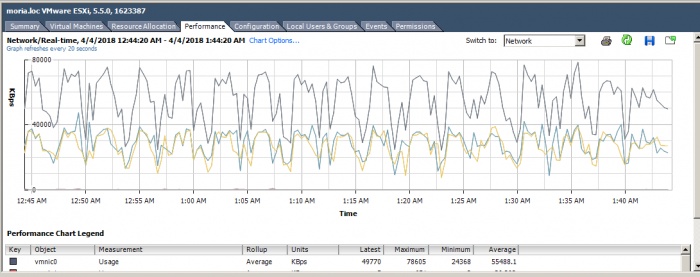

Check if from the vSphere side. I know you love your Linux CLI and what not, but vSphere is your friend here since the system you're having issues with is a VM. Unless you want to learn esxcli.
You don't have a home environment. If you can't peg a GbE link with your setup, there's something very wrong. @VirtualLarry can peg a GbE link with his cheap off the shelf NAS units. I can peg a 10GbE link if I want to but I decided the noise/power requirements for 10GbE wasn't worth it and sold my 10GbE stuff. I've got 4x1GbE links per host for iSCSI. I run my SAN replication job over the single 1GbE management link because it's a differential backup so as long as the backup has been constantly running, there's not that much data over it. Guess what happens though if it's been a while? My management interface is basically inaccessible until the job completes because that replication completely saturates that connection. Have you ever tried to SSH into a router when it's interface is being saturated? Guess what happens, your SSH connection sucks balls at best and will frequently drop.
I'm primarily a Windows/VMWare guy but everything you've describe so far could easily be explained by storage latency and/or host resource contention. Could it be other issues? Sure. Could be a bunch of combined configuration issues. But that's hard to say without being able to actually see your setup. I know you don't want to reboot your storage server, but I'd start there with the power management settings.

Oh I can peg it if I really try, like multiple wget with lot of big files or something, what I mean is that the every day stuff that goes on does not peg it as far as I know. This is what vmware looks like:
And file server: (I had forgot about the iftop command)
There may be a local backup job running on one of the VMs right now as that's more traffic than I'd expect.

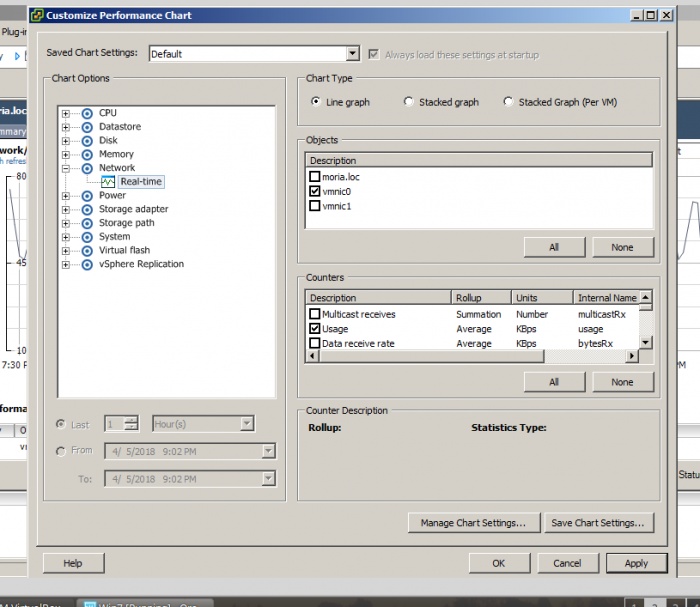

vSphere shows you hitting as high as 80MBps in the last hour. What does the last day look like?
XavierMace
Apr 20, 2013
4,307
450
Chart options, change metrics to just show you one data point. Should let you change it at that point.

I don't see any option like that. I do recall seeing it before when I used to manage a vsphere environment, so maybe it's my version or fact that it's the free version so it's a feature that's not there.

Hmmm. I didn't remember vCenter being necessary for ALL historical data, but that appears to be the case. Could could try running the free version of Veeam One as I think it retains historical data itself, but I'm not certain of that.
thecoolnessrune
Jun 8, 2005
9,673
583
Yeah, vCenter is required for anything other than Real-time. VEEAM ONE collects its historical performance metrics from vCenter. Without vCenter you only get real-time there as well :(
