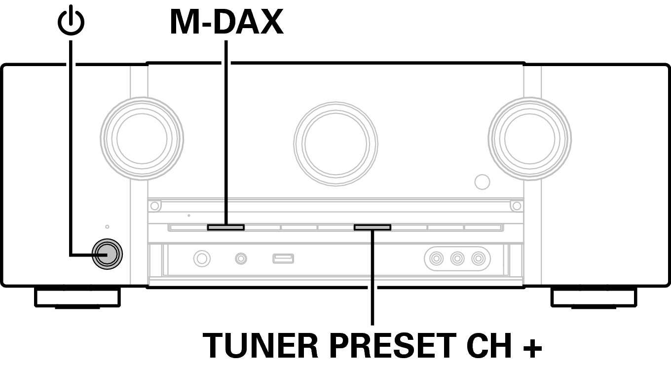

They must have added the firmware rollback at some point since the xx06 series … seems like it started with the 08. My NR1506 turned itself into a brick last night by quitting halfway through an auto update. There’s a repair guy nearby who says he can usually reflash … trying to decide if I want to just upgrade to a newer one instead.
- Put the unit in Standby. (Zones powered off)
- Press and hold the “Button A” and “Button B” buttons on the front panel.
- While holding in the above buttons power on the unit.
- You will see "Restoring FW..." on the display. Once you see that, release the 2 buttons and give it about 10 minutes to complete.
Did you try that? Its what brought this failed firmware process to revert back.
Older versions perhaps?
Restoring the firmware to the factory defaults
When the unit or the network functions do not work properly, operation may be improved by restoring the firmware to the factory defaults.
Do this when the unit still does not work properly even after trying the steps for Resetting factory settingslink or Resetting network settingslink.link, link
After the firmware is restored, various settings are reset to the default settings. Configure the settings and update the firmware again.
Ope Restore S65
Press
Power Button
while simultaneously pressing M-DAX and TUNER PRESET CH +.
When “Restore FW...” appears on the display, release the buttons.
When the firmware restore is complete, “Complete” appears on the display for about 5 seconds, and the unit automatically restarts.
Yeah they added that a generation or two after the NR1506. I even sent it to the repair dude and it turned out he couldn’t fix it without a ~$350 board. I told him to salvage it and bought a refurb NR1711 instead for $650 which has been a nice upgrade. Simplified my cabling and setup since it has HDMI 2.1 and Spotify integration for listening from my phone is much improved. As long as it doesn’t break it should last at least a decade technology wise, probably longer.
