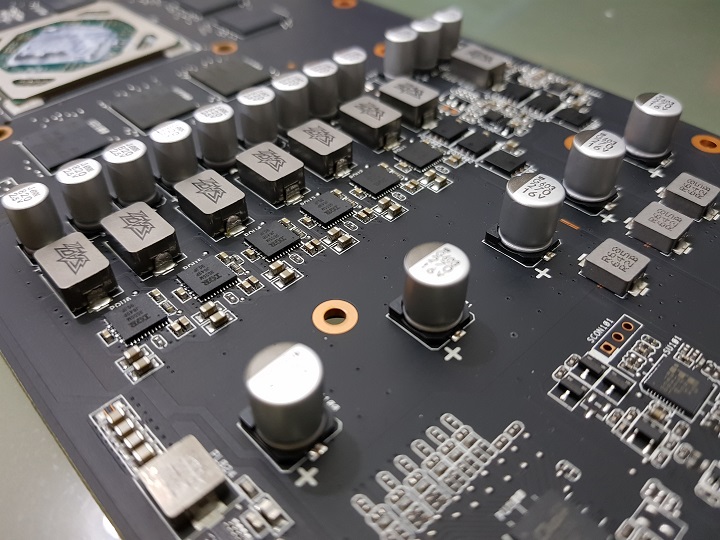

I am considering doing this myself, but when I
checked out the 580 online the strix 580 has 7 power phase where as the 480 has 6...also the heatsink appears to have been redisgned..albeit very slightly. I am curious as to what other changes they have made.
As a follow up, I did some study on the RX580 STRIX PCB design (specifically the VRM) vs the RX480 STRIX, and it looks like the RX580 is indeed identical in design to the RX480. The parts are all identical, the layout is identical, and I think ASUS is mistaken in calling it a 7 + 1 design as the top two VRM's are clearly not vcore.
Look at these two photos. Take a guess which one is the 480 and what one is the 580!
The only change I can find is the modified heatsink with the improved frontplate that covers the VRM's and is thermal padded to the heatsink. However, I am unsure if this really cools the VRM's better than the direct heatsink->VRM design of the RX480 STRIX.
I had based by my information on marketing/advertising specs listed on the ASUS site. Which I should have known better. After looking at both of those pics it appears the PCB is atleast the same as it was before, or if there are any differences they are likely minor ones. The actually heatsink/pipe design on the cards may be different, I am not sure about that though.
