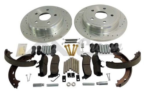

My Jeep has a separate brake drum built into the rear disc rotor. It's a separate park brake system. IIRC, there are many vehicles like that. The "hat" part of the rear rotor is used as a small drum park brake.

The drum style is by far the most common. Systems that use a mechanical device built into the brake caliper actually seem to be becoming increasingly scare; probably because manufacturers realized they sucked ass. They don't hold the car as well, and rather than providing a failsafe, they can actually sabotage the normal hydraulic service brakes.
If you drove with the brake on without noticing it (and it is indeed a drum inside the rotor hat), it either wasn't working worth a damn to begin with, or it was not fully engaged. Worst case scenario, you got the shoes super hot and the next time the rotor is pulled, the friction material will fall right off the shoes. They are always bonded shoes, and the impression that I get is that extreme heat basically makes the adhesive fail. The friction material usually just falls right off the shoe in one piece and then shatters on the floor.

It depends on what type of rear brakes you have. If disc brakes the parking/emergency brake is separate from the regular brakes.
This is wrong as a blanket statement.
Many companies use mechanisms for the parking brake that cause it to actuate the caliper for the rear disc brakes. Ford and GM both prefer such systems on cars with rear disc brakes. These cars have no separate parking brake.
While some cars with rear discs do have a small drum brake for the parking brake, this is typically only when the vehicle uses fixed calipers instead of the more common single-piston floating caliper designs.
In the case of the OP's Passat, the parking brake uses the normal service brake. If he drove for 20 miles with the parking brake on, his rear brake pads are likely quite nicely toasted.
