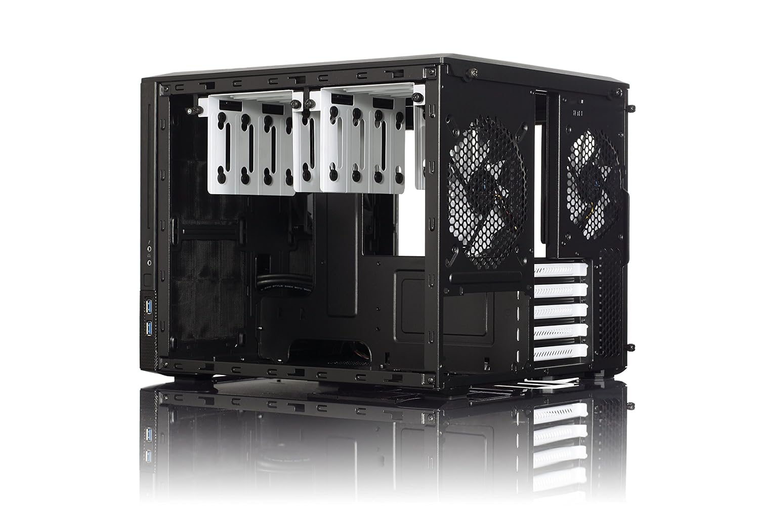

Upgrading a system that currently has a Celeron G3250 (53w) and bundled cooler. Going to an E3-1231v3, which is an 80w CPU.
Hoping to get a recommendation for a non-tower clip-in style HSF that will do the job. (So, something similar to the OEM design that will be easy to swap w/o removing the motherboard.)
Case is a Node 804, but I'm not interested in water cooling.

the clip retention system is horrible...
If im not mistaken on the case, it has a open cut out behind the cpu so you could use a hard mount without board removal.
Being the case i would recommend a phantek slim

I just don't want something huge, and I was hoping to not have to remove the hard drive racks from the other side either. I really am that lazy.
I also don't want something that's not-quite ATX spec, since even the little Intel cooler doesn't leave a lot of room by the RAM slots.
But, *sigh* it's really not THAT much work. I shouldn't be so lazy, and that Cryorig looks alright. Thanks!
