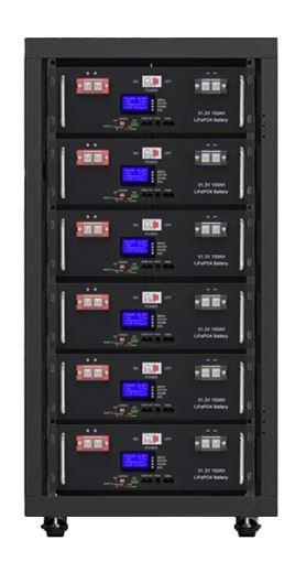

In that case look at nat gas generators.
im actually in the middle of getting permits to get this installed:
I have the 12kw solar array.
Its just down to either a tesla wall, or a DIY bank.
Im more leanning to the DIY because i can service it and change out the 48V LiPoFe units myself as its just 4U racks.
But the Tesla Wall makes monitoring stupidly easy, also i can mount a tesla wall outside.
But regardless both require electrical permits to be filled.

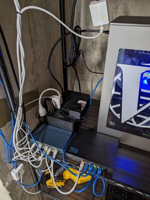

Nice setup! I assume you'd need to buy client NICs too at added cost.
I just have a QNAP 5-port 2.5Gb unmanaged switch I bought for about $110. It uses existing Cat5e/6 cabling, and my file server, the Zyxel AP (I use a 2.5Gb POE+ injector for this), and a couple of my computers have 2.5Gb ports built-in, so no additional client NIC costs. The 5th port is uplinked to a $20 1Gb switch for more mundane stuff like TVs, gaming consoles, laser printer, etc. I'm lucky and have Google Fiber 1Gb service for Internet service.
