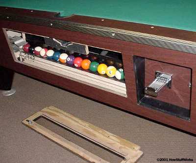

How does the pool table know which ball is white? And how does it always show up in the front?
Been a while since I played pool but if I recall the cue ball is a little bigger than the other balls so there is probably a mechanism where the smaller balls can fit that the cue ball can't so it splits them up that way. I guess similar to one of those money sorter machines. Wild guess though.
My parents had a pool table, your reply is exactly how their table worked. The cue ball, being a bit larger, would hit a bar at the top and be directed towards the front. All other balls which were a bit smaller didn't hit that bar and were directed towards the other side.
