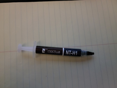

I used the whole tube of the Noctua thermal paste that came with my D15 G2.

Whole tube? How big was the tube?
I'm guessing that was probably about 4X too much. If you are now out of thermal compound, I'd take a credit card and salvage about a pea sized blob, get rid of the rest, then put the pea sized blob on, spread out slightly on the middle, or the pressure of the heatsink will eventually do that, settling in to a lower temp over several thermal cycles.

The WHOLE TUBE of Noctua TIM? That tube, if it's like this one that came with my Noctua cooler more than 10 years ago:
contains enough material to properly seat at least 10 coolers to CPUs.

When I applied the thermal paste, I tried to follow the Noctua instructions, and put one dot in the middle, and then four smaller dots on the corners. That was my first set of squeezes.
However, my paste didn't end up coming out in the way how I thought it was going to, and how I wanted it to.
So I gave it a second set of squeezes to try to fix that problem, and apply the dots in accordance with those instructions.
And after that second set of squeezes, the tube was empty. It emptied much faster than I thought it would (but I'm not an veteran of applying thermal paste...I've done it a few previous times, many years ago...I haven't ever done it a lot, though).
