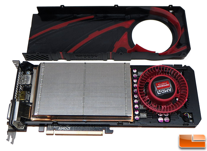

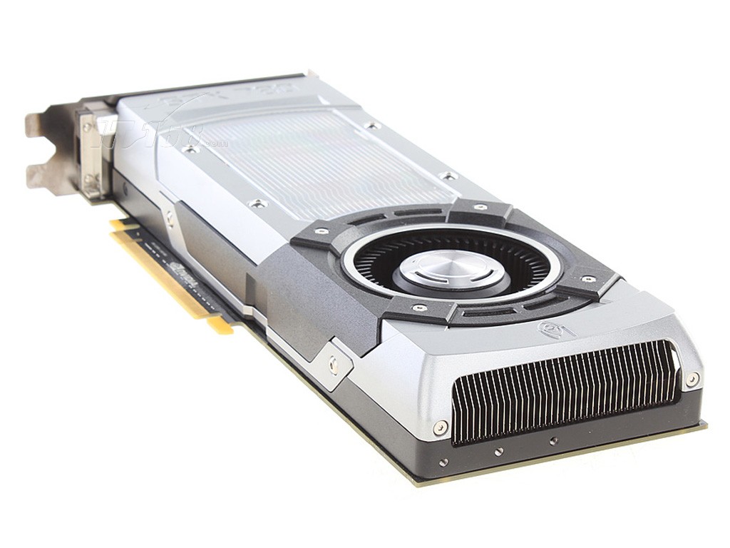

If you use headphones is a moot point. The Nvidia blower can also get pretty loud, but for some reason is not as harsh (sorry don't know another way to describe it). I think is because the Nvidia blowers have a passthruh design for the intake part of the card. While AMD the intake is at the blower itself.
See the big opening! AMD does not have something like that. The intake of the AMD blower is the fan pretty much. It does have a few small holes around the fan, but i think they actually cause the sound issue with the card.
I believe that's causing some harmonics to come out of the AMD blower that are more noticeable than the nvidia design.
