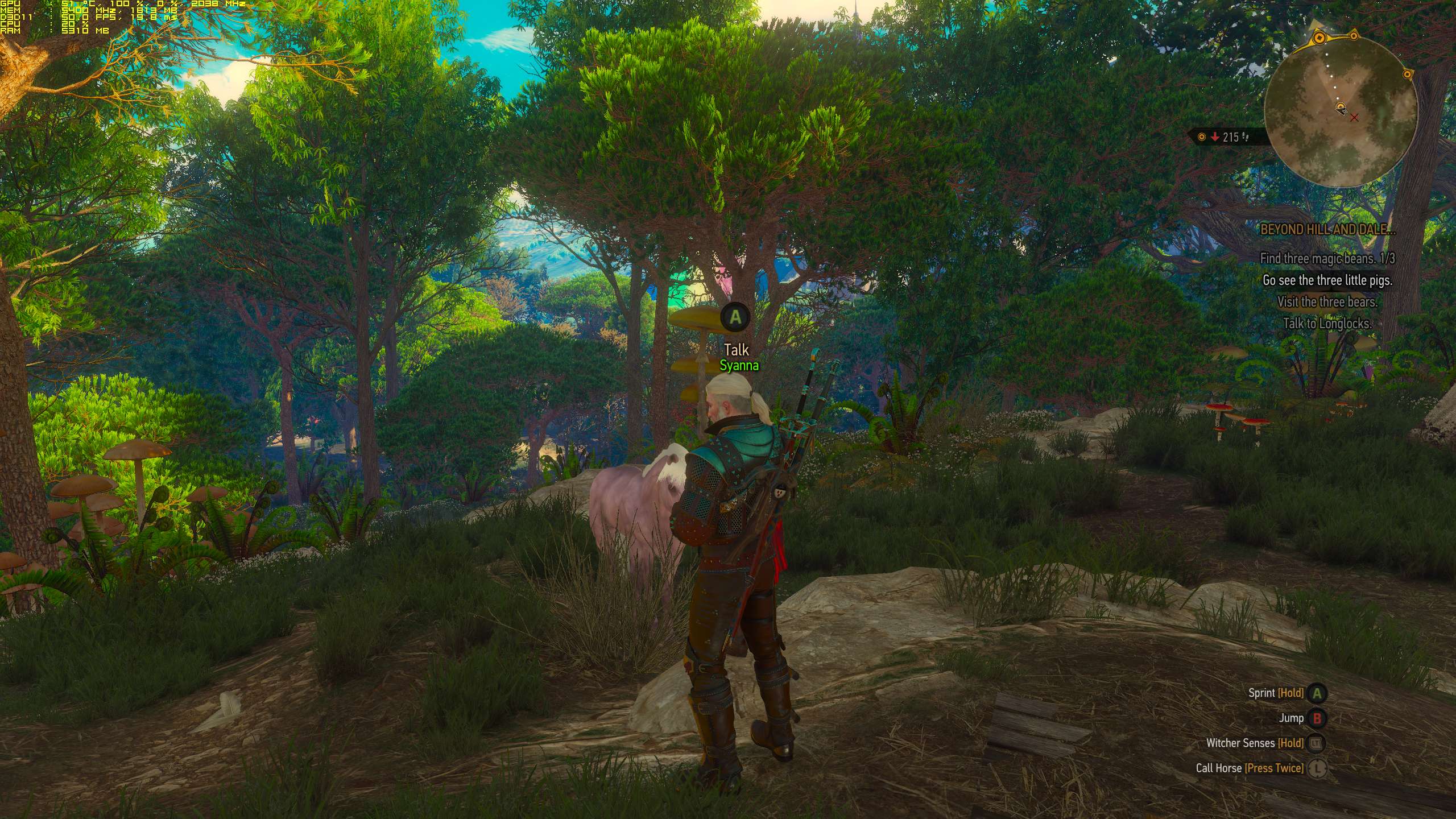

The catch was under graphics intensive scenarios. Let me give you an example of what I consider graphics intensive scenarios. Witcher 3 is a GPU intensive title we can all agree right? There are some places in that game where the GPU is hit especially hard. One of those places is in this screenshot that I took when I had my Zotac Amp Extreme GTX 1080.
The framerate in this screenshot is 50 FPS, which is much lower than average for this card. The reason why it's so low is because of the shadows which is on ultra, and the unicorn which has hairworks enabled. Despite the card running at over 2ghz, it throttled down to below 2ghz or so after a few minutes in this area.
I have no doubt that an aftermarket 1080 Ti would throttle down below 2ghz in this same area as well.
